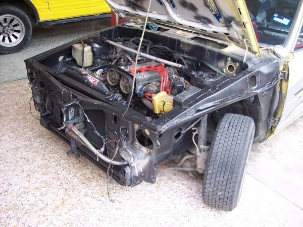

Today went to check on the progress so far.
The roll cage is in! The holes have been drilled and now customising the under plate. Also the spot welding has been completed on the engine bay, fenders and cabin area. Will work on the rear section soon. However he is leaving out the rear cabin cross bar for the moment to ease the instalation of the R32 axle later. Next he will work on the chasis where the it has been cut to fit in the gearbox. Additional bars will be welded onto that area to prevent flex and increase strength.
Some pics taken today :
1. Absorber mounting point, all spot welded
2. Driver side. Notice the additional bar painted in red next to the oil filter.
3. Behind fender, right side. Painted red after spot welding
4. Another view from the front
5. Door area
6. Levin head. grille not fitted to ease removal/fiting of bumper
