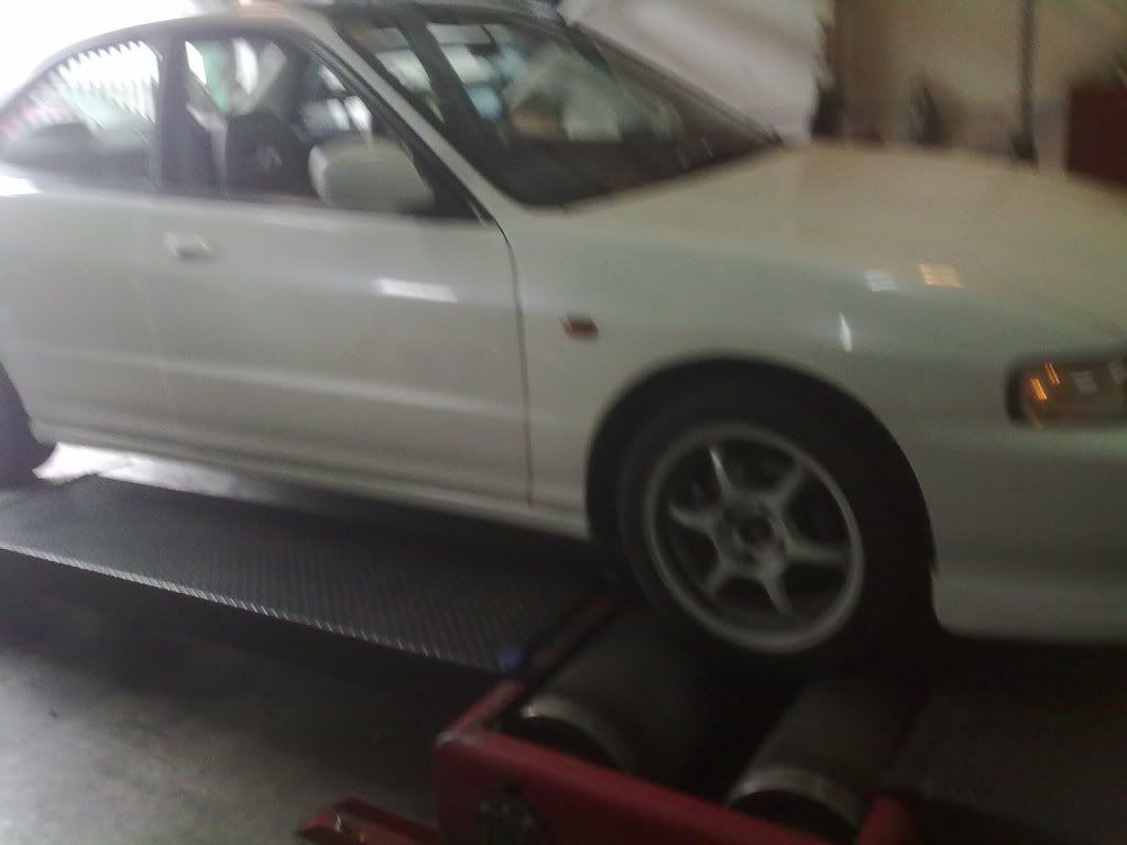

Car already on the dyno machine.

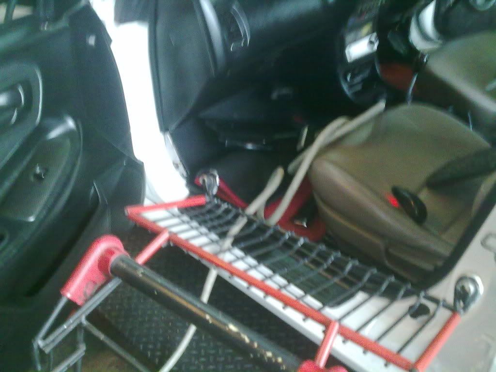

Some cables, don't know connecting to what:

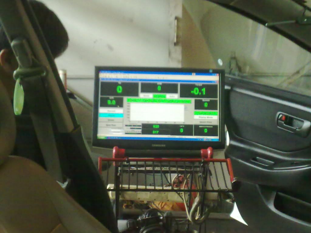

The monitor (as if you didn't know that, hehe)
That's it. First dyno run completed.

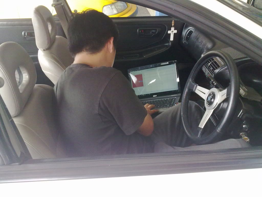

When I came back a few hours later, my mech had already installed the Hondata and started tuning (i think). He was playing with his laptop in my car:
Then, he went road-tuning 4 times while I stayed back. So many times, is this normal?

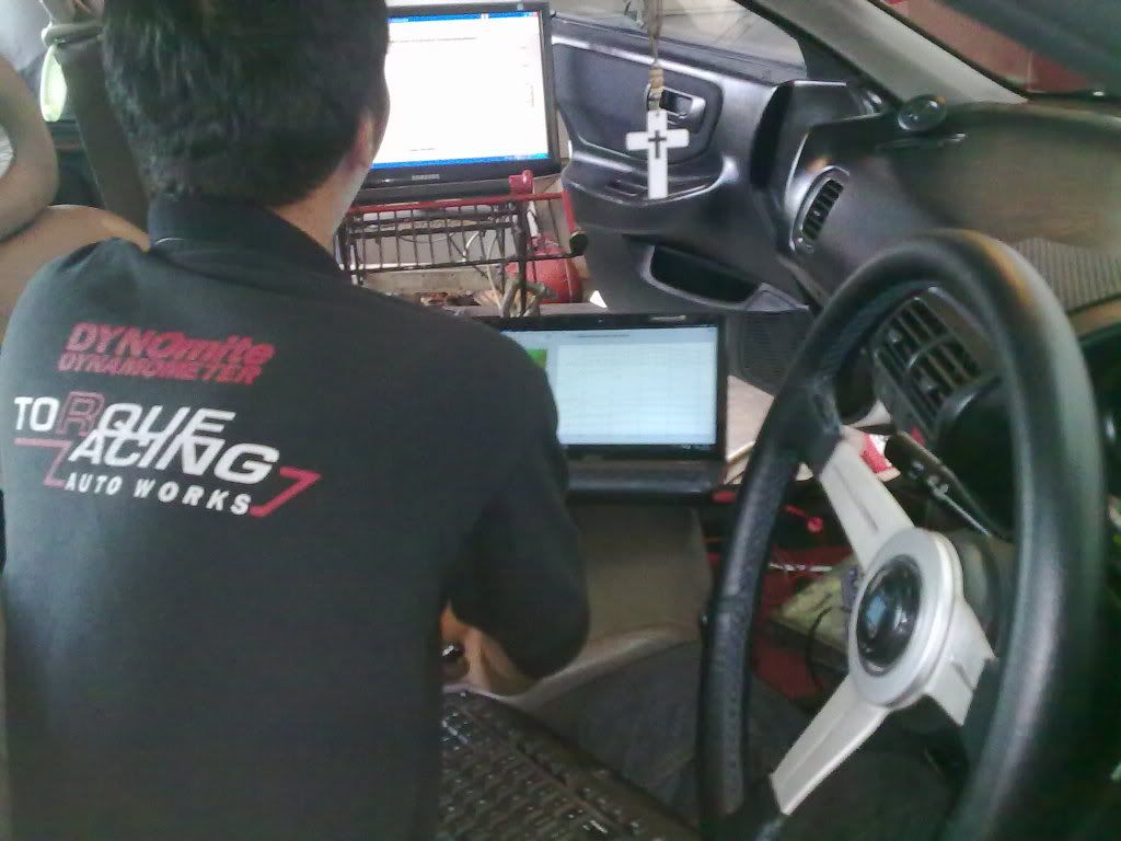

To dyno tune, the dyno guy is the one who did it, I don't know why:
He took quite long to tune. Maybe something was wrong. We even had time for beers while tuning. :beer::beer: Time to time, my mech would spray water on the radiator, IM and fuel rail.

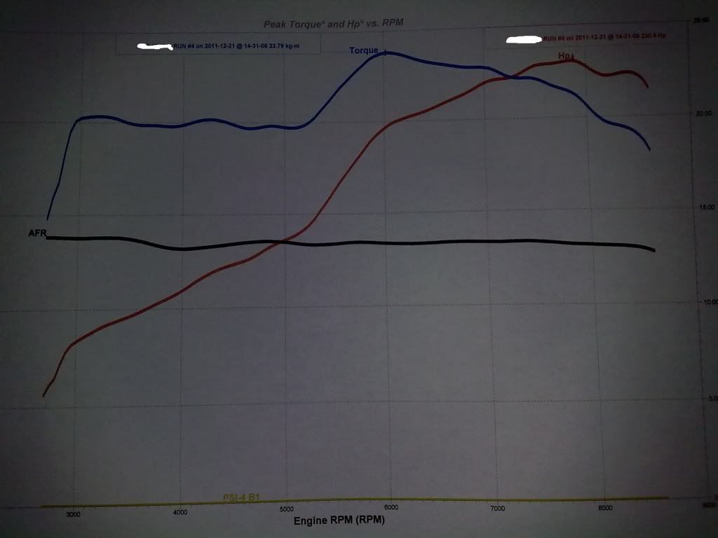

In the end, this was the result:
2nd dyno graph shows: 23.79 kg-m torque/230.5HP at 7850 RPM.
Summary:
+ 1.75 kg-m torque
and
+ 10.6 HP
with Hondata
Is this good? Normal?
I don't understand what those curves and figures in the graphs mean. All I can say is that both my mech and the dyno guy said it was good. To me, I don't know whether I should be happy or not because they didn't tell me what is good. Anyone here care to explain?
Guess that's it for now. I will post the pics as soon as I can. Stay tuned for more IMPULSIVE PURCHASES. Hehe.

Yes bro. If you look at the second graph, there is a black line AFR. No figures but its like a almost horizontal line. It starts off at about [email protected] RPM. Then dips to about 13.0 at 3.9k RPM. From 3.9k RPM to 5.8k RPM, it goes up and down a little, very little actually maybe about 12.8 at the lowest point and 13.2 at the highest point. From 5.8k RPM all the way to 7.9 is pretty much a straight line. Then dips a little more at about 8.5k RPM to about 12.7.
I hope this is what you want to know. If yes, what does this mean?

If the graph falls below the red ---------------- benchmark in red in the sample that i've shown, means that the car's FC is bad. That's what they told me when I dyno-ed my car last time. The benchmark for me that time was 13, not sure its applicable to all or not. Vice versa if it is too high above the line means its running too rich. Correct me if I'm wrong.
---------- Post added at 12:39 AM ---------- 6 hour anti-bump limit - Previous post was at 12:36 AM ----------
No, it's ok as you can refer to the vertical on the right of the second graph AFR for the figures. Just that you may need to use a ruler to compare to the benchmark :biggrin:
Ok. Now I understand. I think I remember my mech said that the car has to run a little rich but I can't remember if he said why is that so. My AFR is also around 13. I hope my FC will improve. Will it improve?

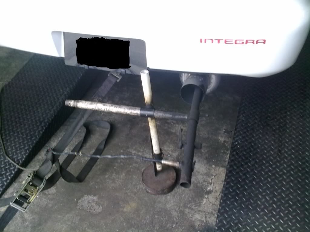

This is the thing that they put inside my exhaust. What is it and its purpose?

The thing in the exhaust is the equivalent of a O2 sensor for the dyno to measure how rich or lean you're running.
That's a nice even torque curve (prior to the VTEC kicking in) and 230bhp is helluva a lot! But I just realised yours is a 2L. You probably could do better with more impulsive purchases. :biggrin:
Nice AF line though, very linear so you're running leaner as the RPMs go up. Did you check your engine temp at the high end?

170whp~180whp is what that commonly expected...and actually if you are going to dyno @ works..expect higher figures. but bro...don rely so much on these figures...doesnt really mean much...
But last time my friend one hide in the same way with magnet bar/stand on the dashboard,the car still give some god damn theft broke into and the SAFC,VAFC,HU,Audio AMP.etc varnish ~ so gotta be careful with that ~
Ok. That must be for the AFR reading i guess.
Aiks, 230BHP and 230HP. Are they the same?
Didn't chek the engine temp, I don't know if that was included. But my mech kept spraying water at some parts in the engine bay in between the dyno runs.

Bro ddv_nk12 , about the WHP calculation,it's not true/accurate......a engine that had high power will lose less to the drivetrain components,if according to your calculation by percentage then it ill be the bigger the engine horsepower,the more horses it lose to the drivetrain.....get a proper WHP dyno ~

BHP more accurate,as it name,it called as Brake Horsepower which the machine will apply load to the vehicle wheel to stimulate real world driving ~
20-30% loss??? typically i hear is about 15% only...
but if based on 15% then ur pushing 187hp before hondata and thats already a healthy engine...
after hondata ur pushing 196hp.
anyway...engine looks good..nice and healthy... time to get some higher compression pistons and some high cams :D

DD- 12++ to 13++ AFR means your machine is running lean....u might asked the tuner to tune for more power and save fuel at t he same time........boss....

Does it mean that if my AFR is rich, I'll get better FC and more power at the same time? I told my tuner about my car running rich previously. He said he can tune to make it leaner. The smell from the exhaust was really bad. Now still there but not always and not as bad as it used to be.
