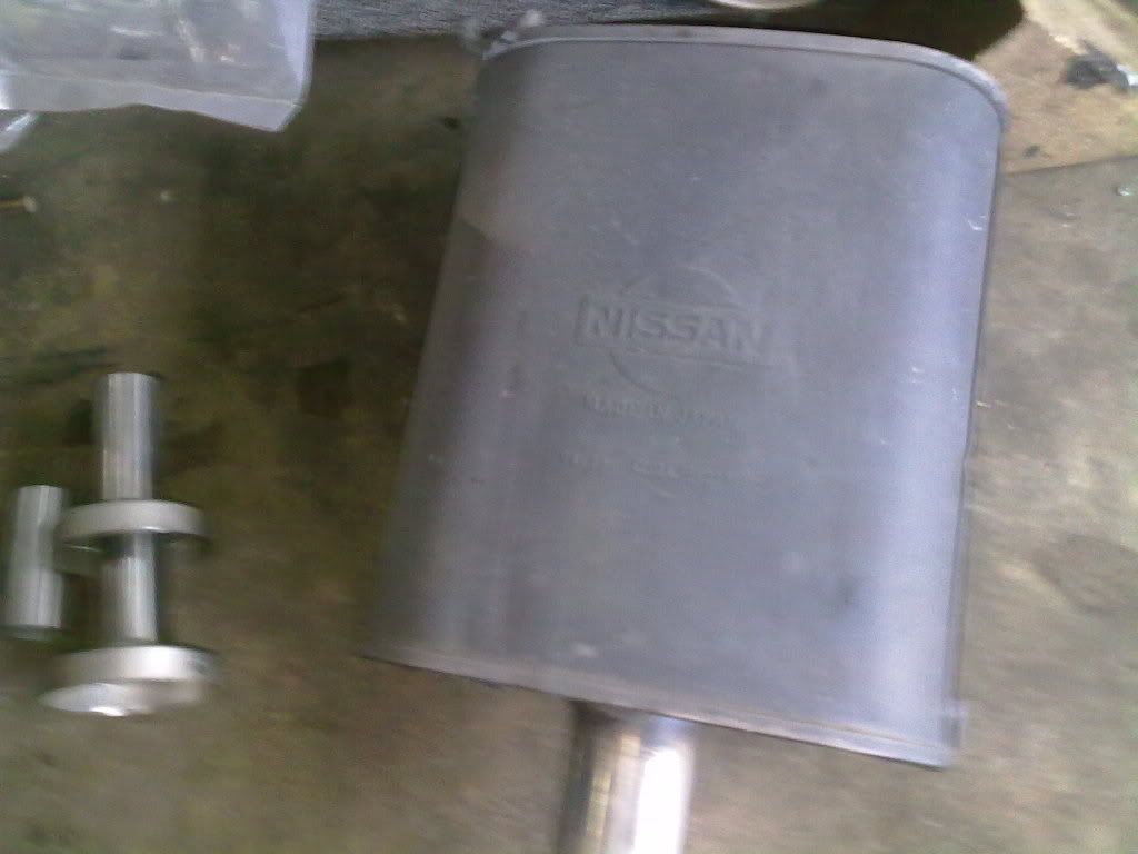

First, the old muffler had to be brought down.
This was the old muffler I was using.

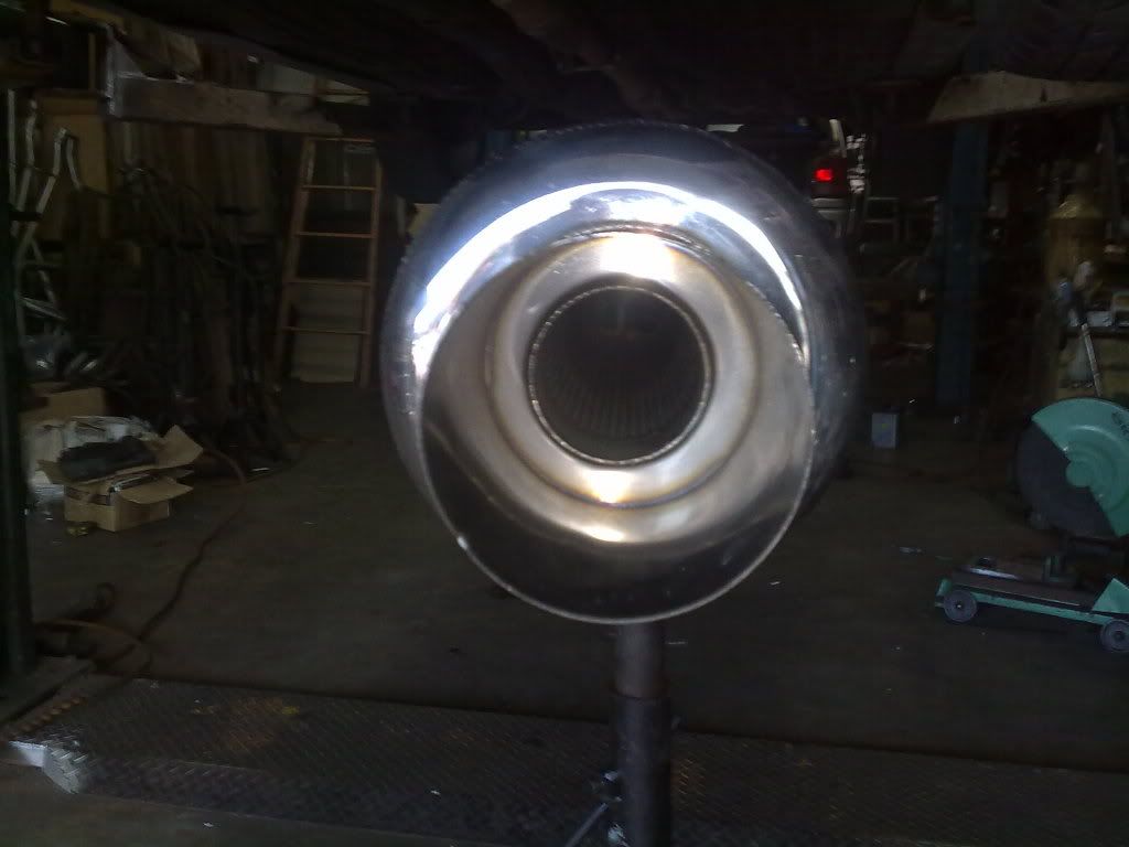

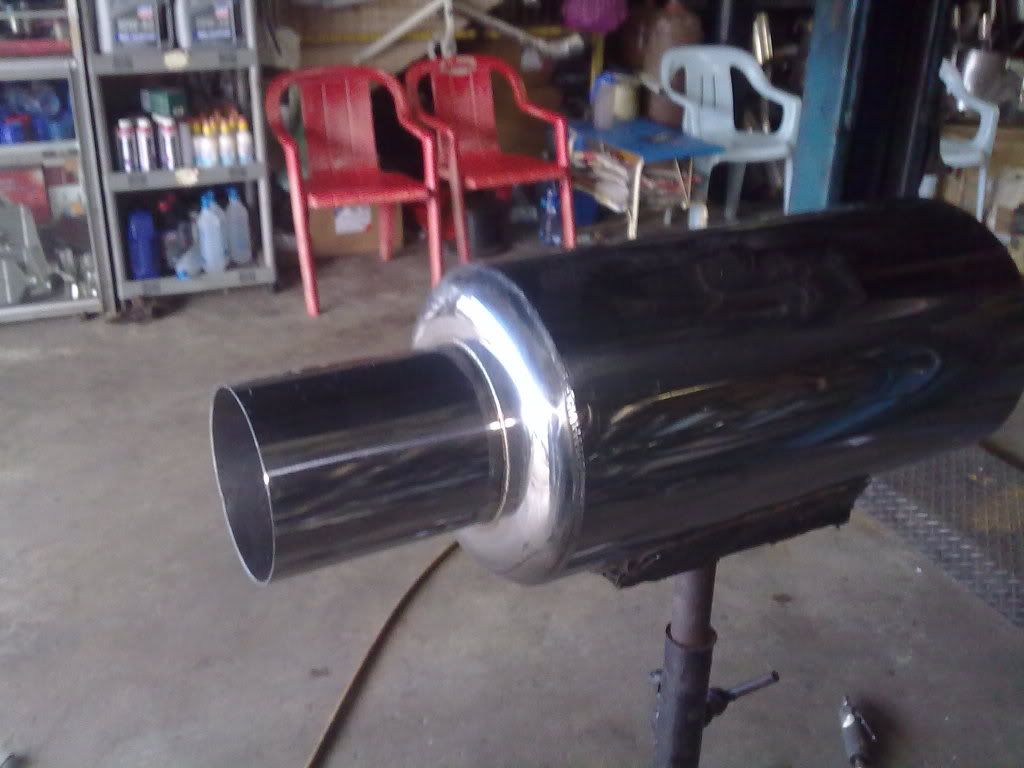

After testing a few, I decided to go with this.
It's cheap and sounded good too. Performance wise, I was told it's the best since it's a straight flow.
Other views

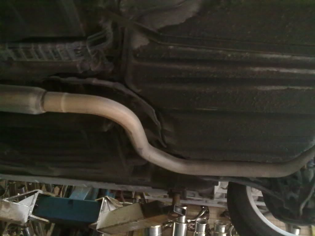

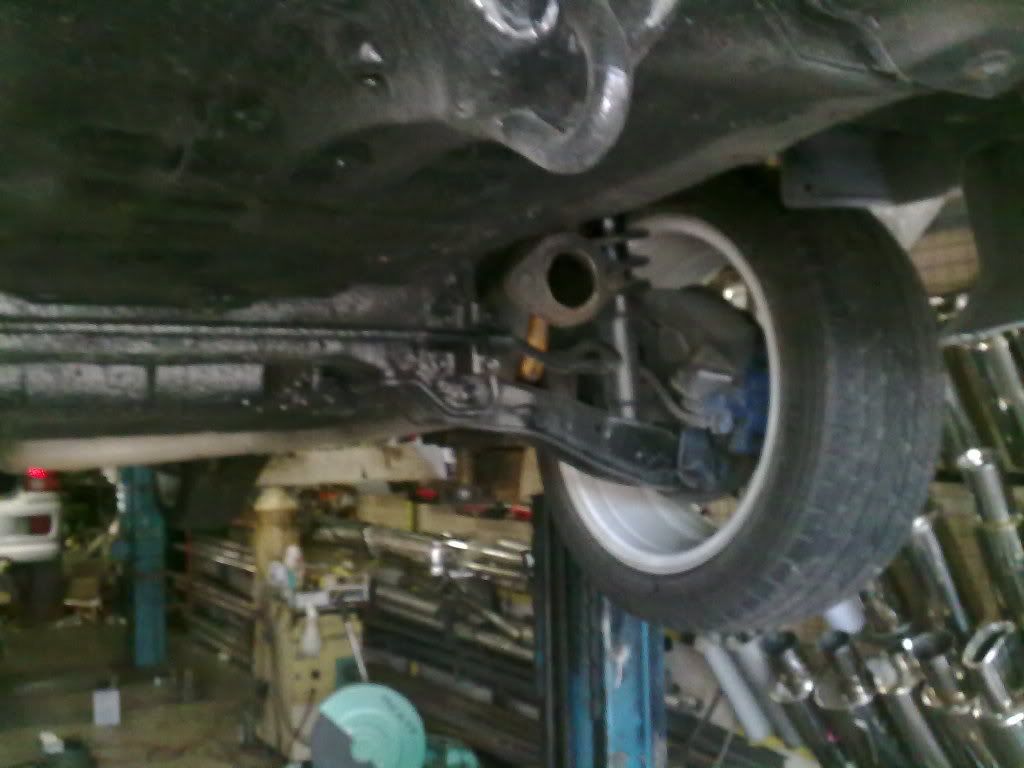

Did not change the piping but he checked to see if there was any leakages.

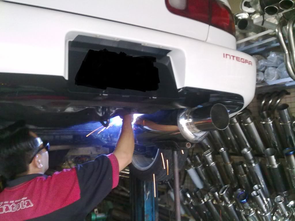

As it was good to go, here he's working on it.

I just realised something.
BLASPHEMY!
A Nissan muffler in a Honda???
