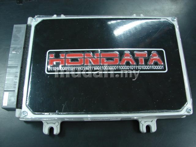

anyway, back to my rebuild thing. I was talking to my mech yesterday. he said my car needs some tuning and its also important to have something to tune since i'm using b20. he suggested hondata n quoted RM2800 for the thing plus installation and tuning. i asked him whether its s300 or what? he showed me the pic in the attachment. what is this actually? i mean i know its the ecu but which model? my friend in KL checked in N1 for me, they also suggested to use this. RM3k with installation n tuning.
i tot i have to use the s300/s300j which is cheaper. less than RM2k in mudah. whats the difference between this two? i know s300 must use back my current ecu box but the other one no need.
anyone can help clarify this?

thats basically the S300 which has already been installed... wat ur mech offered u is supposedly better than buying the s300 board and soldering it into the stock ECU. and at 2.8k i think its a pretty decent price. i got offered the s300 board with install n tuning etc for 2.5k.
i saw get this... n keep ur stock ECU for spare. or u could even sell it to cover back cost
icic. now i understand. 2.5k just for the board plus tuning and all is quite expensive though. how much does it usually cost to tune only?

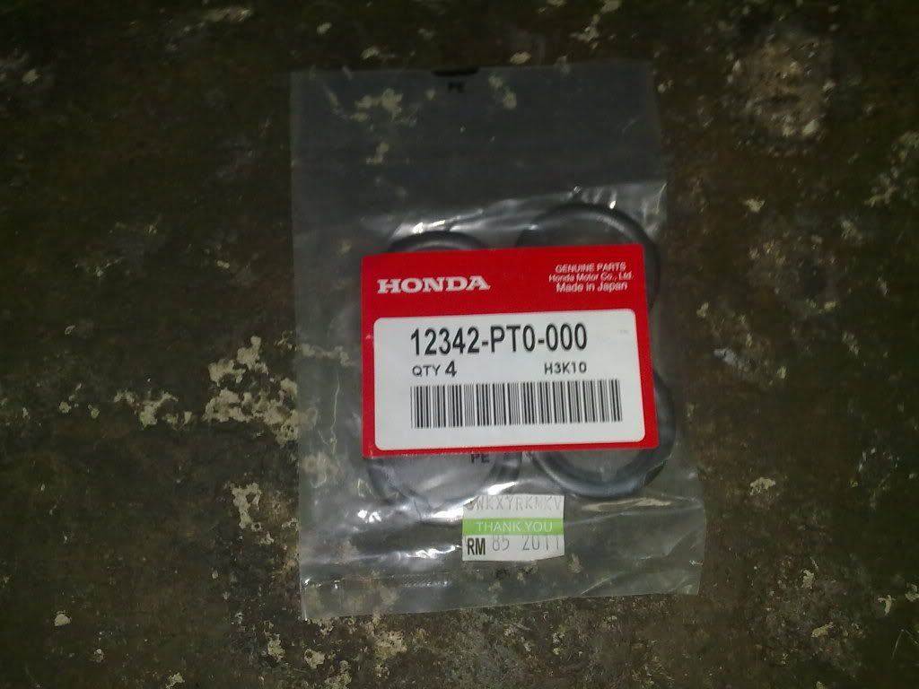

when i went to service, i found that the engine oil found its way to one of the spark plug area. was told to change the o-ring rubber.
this is it:
and this is the new rubber
the rubbers must have hardened over time. thats what the mech said. just to confirm should i be worried bout anything else?

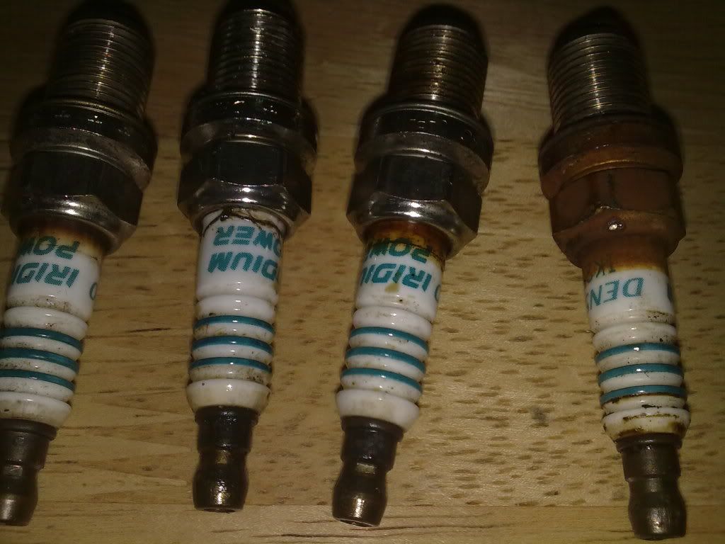

then when the plugs came out, things got worse for me.
check this out:
why is the one on the far right so rusty compared to the others? the mech told me that its because water went in prolly when i wash the engine. is that the only cause?

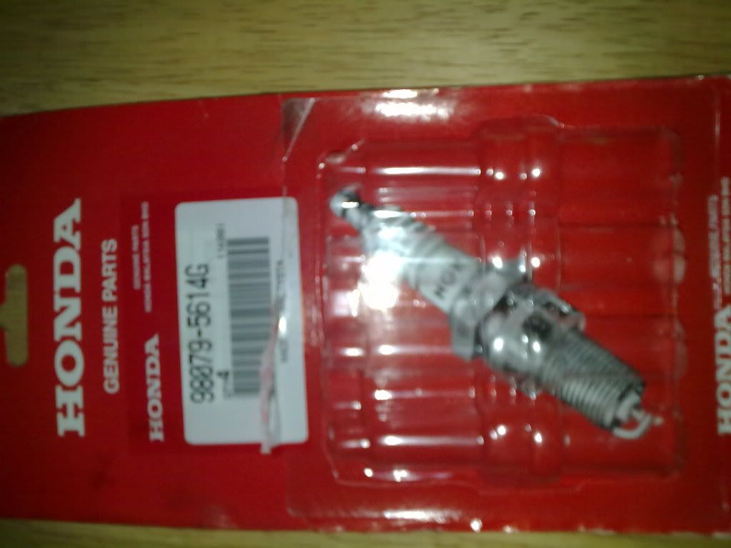

anyway, i replaced with these. is this ok?

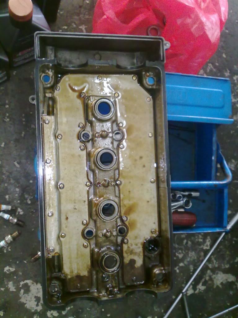

then, to replace the o-ring rubber, the head valve cover had to come off.

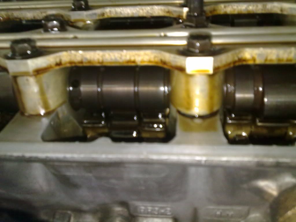

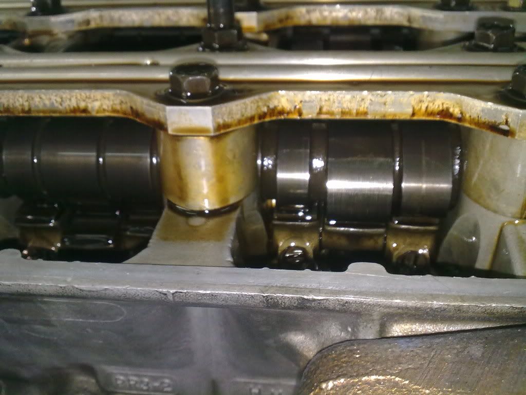

since it was off and i wanted to know what cams are in it, i asked the mech there. he said it "looks" like b18c type r cams, meaning that he's not sure. i was thinking i was using the b16 cams. even though 2 of them said it looks like b18c type r cams, can i get a confirmation from Honda sifus here whether or not its b18c type r cams or whatever cam it is?
hope this pics will help.
cant really tell what cams are those unless we see the ends of it. at least, for me. i dont think there's any other way to tell unless u remove the cams.
That's a lotta varnish. What engine oil you using?
noted. thank u boss. just hoping for a shortcut. hehe.
whats varnish and why? i mean i know varnish but what has it got to do here? the oil dirty? i was using honda semi synt in my previous service.

Varnish is usually indicator of a poorly broken down oil or you extended your OCI too long. Look at my pics, mine can still see the silver bits of the aluminium with very little gold. Yours has a lot of gold. Either shorten your OCI or use better oil.
Rust is caused by moisture and oxidisation. Either you washed your engine bay and didn't cover the plugs properly and went for a hot run or you have a constant supply being fed to your plugs (don't know how)
thanks. my guess is the oil. i was told that i could use semi synth for 8k km. but i changed it just over 5k km. so i dont think its the oci. anyway now i'm using a different oil. in my next service, how would i know if there is a lot of varnish without opening the valve cover?
