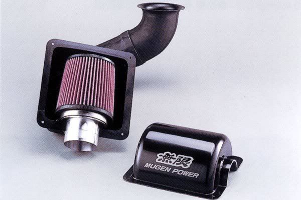

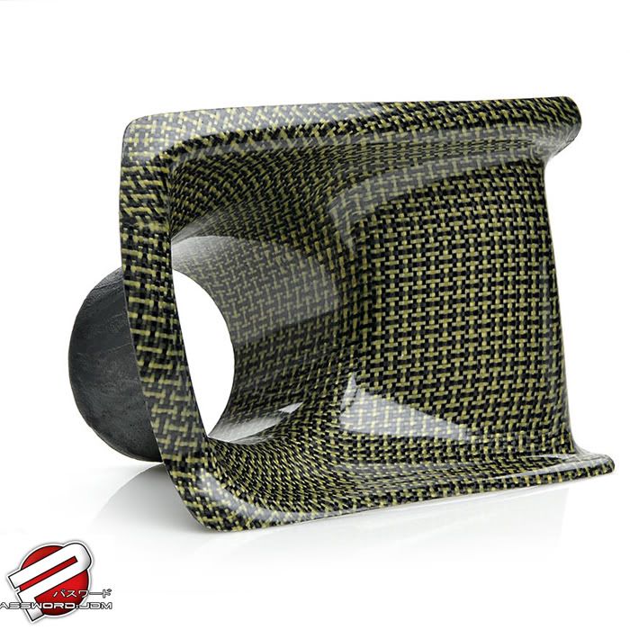

talking bout that airbox, i actually had this in mind
and this
and eventually get this
dont u think it would be awesome if i can actually do this?
i know i can get the mugen airbox but will it serve the same purpose as a custom airbox?
and about the air duct, where can i get it? in malaysia?
since we were talking bout custom carbon fibre, where do they do it? is this service available here?

thats a j's racing airduct... not sold here unless u can find someone to replica
check the marketplace... theres some EG6 Js ducts for sale...mebbe they can custom for ur car oso

yeap, just found out that its the j's racing air duct. replica cf air duct also will do. just dont know where to do it.
any idea if the mugen air box will work. i'm thinking of bringing the air hose from the bumper through the fender and come out at the opening at the fender like in the picture above but pull it out longer to fit straight into the mugen box. is this possible? any has tried it, pls share. thanks.
bro...were in malaysia... u do that u run a high risk of water getting sucked in and hydro locking ur engine...coz u have a box so the hose is the only source of air...
if purely open pod then not much of an issue la...

if u put the box and hose and direct the hose to the duct at the bumper... u have to remember that the only source for the filter to get air is through that hose....
imagine u driving in heavy rain, then u run over puddle or watever and basically alot of water gets into the airduct...all that water is gonna be sucked into ur engine...not good...engine koyak
this is scary.. so, can i say that its best to leave it as it is? or is there anything else i can do?
thanks for the explanation bro.

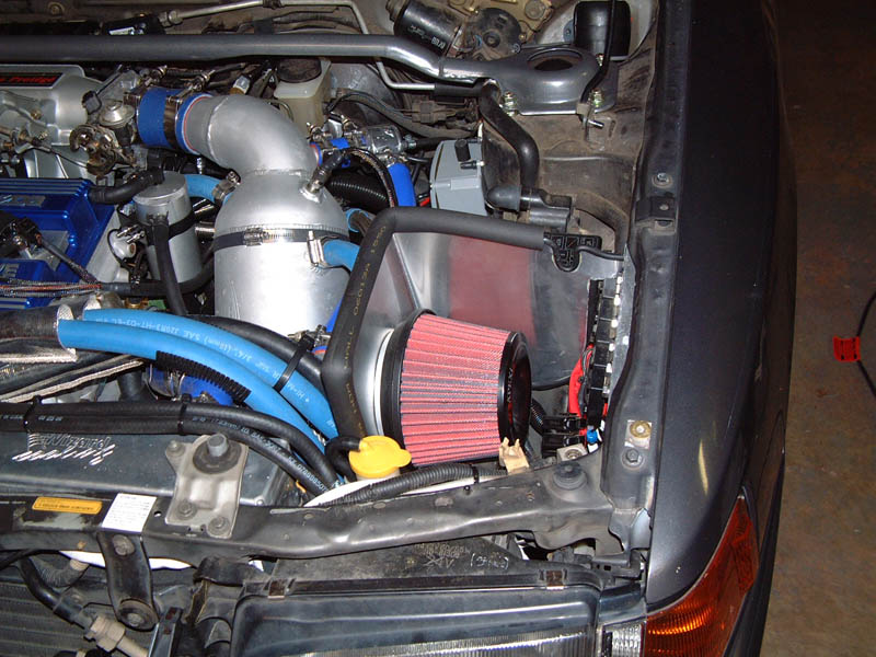

get a heatshield for ur air filter...
u can still get the duct... and route the hose to ur duct...kow tim.
is this what you are referring to?

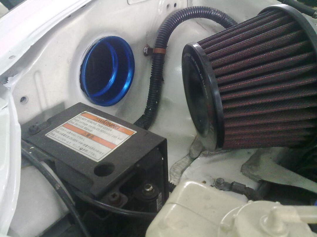

madman,
right now i have my air duct and the hose as shown in the pics below. n i guess its not serving its purpose.
so, please correct me if i'm worng, i need to get a heat shield like the pic in my previous post in order to help increase the performance even if its by a small margin?
thats actually pretty decent already... getting the Js duct will help to direct more air into the hose...
ur already supplying cold air to ur filter... a heatshield will minimize the amount of hot air being sucked in.
my car dun even have heatshield... cai hose oso dun have :P
thanks for explaining mate.
