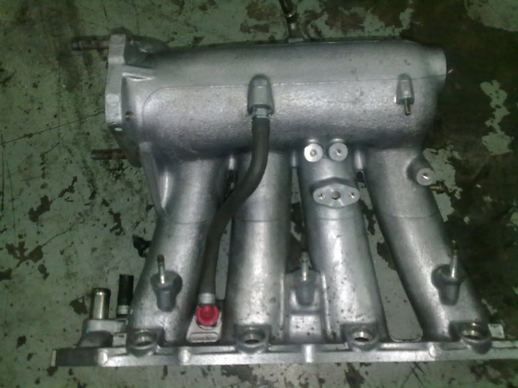

b16 intake manifold was working fine but needed a swap

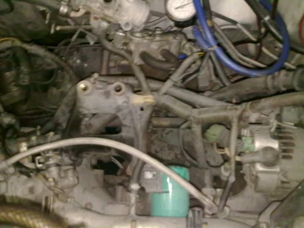

IM n TB is out
looking messy
clearer view of the old IM n TB

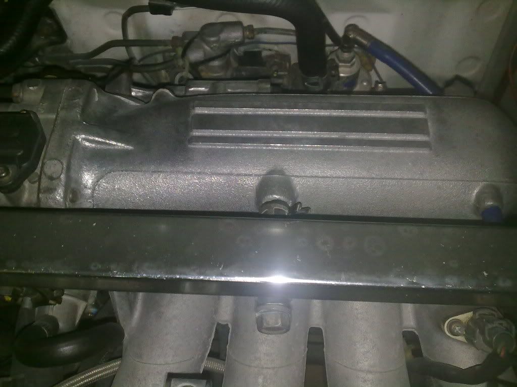

whohuhu - my new used b18c IM

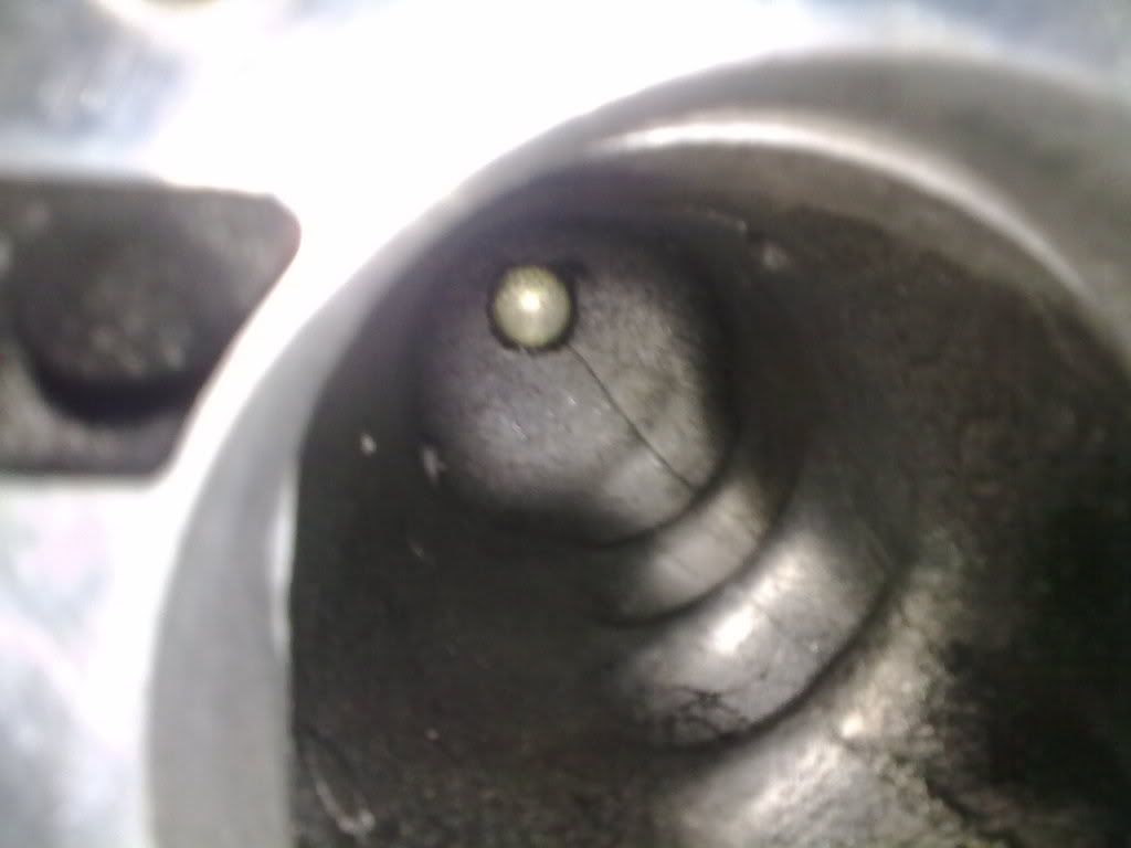

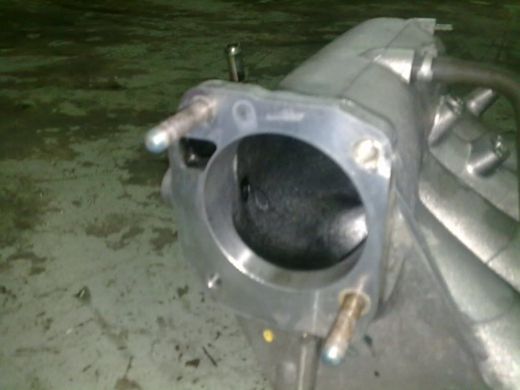

ported 70mm
larger room

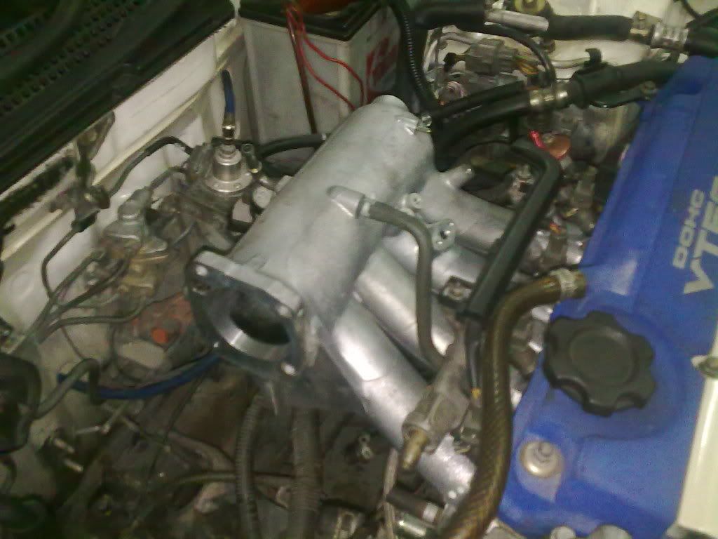

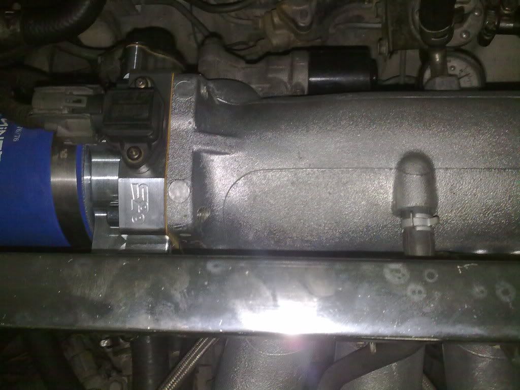

IM is in

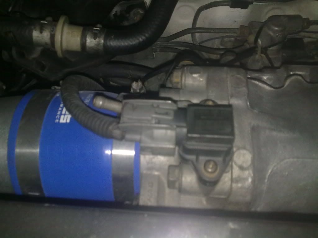

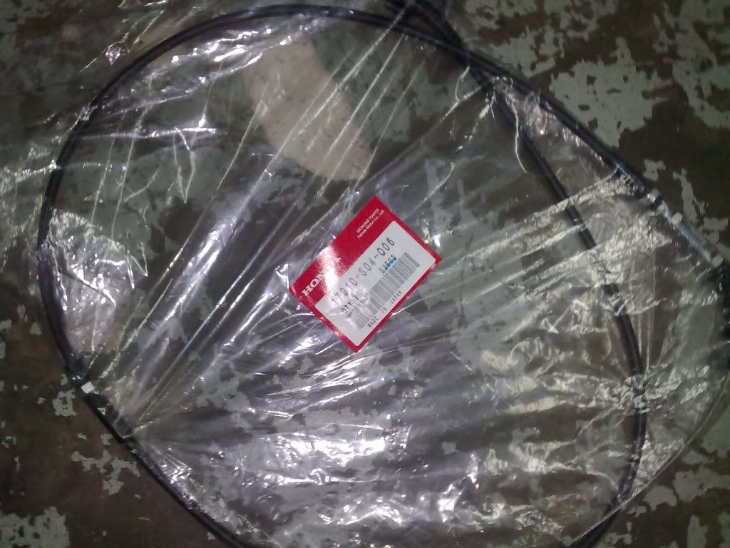

i dunno whats this but it needed to be changed as well, its the cable that goes to the accelerator

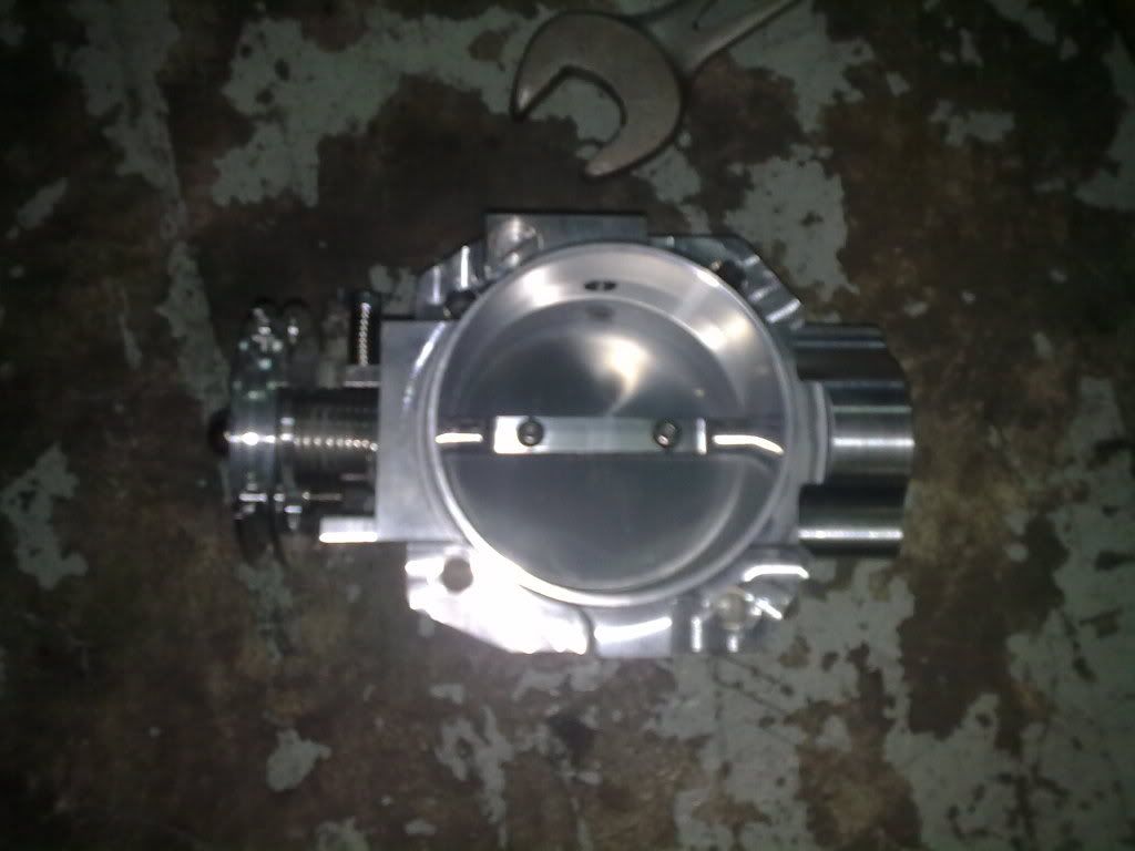

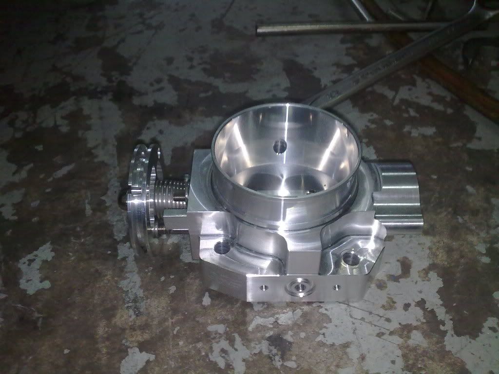

my new s90 70mm tb
i just like the shine

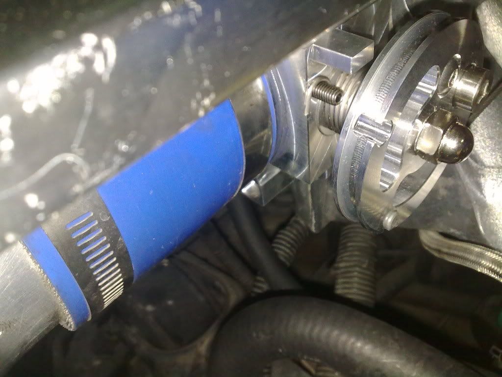

here's the IM n TB
another view
and the last pic for now
overall i'm pretty satisfied. just hope to hear bout the reason why the plug cable came off while some hard driving
