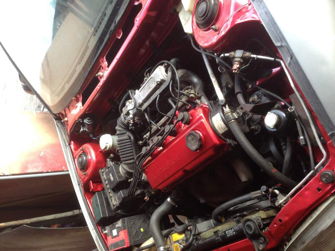

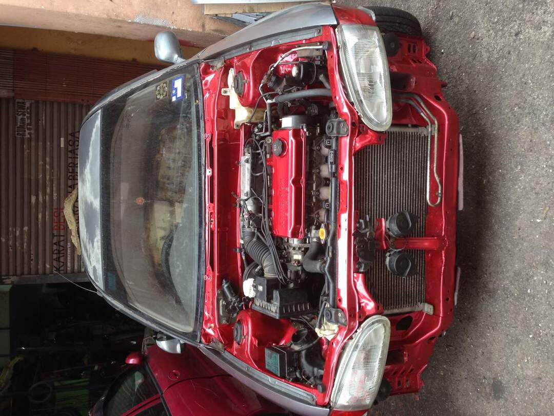

Hi! I recently converted my '00 wira 1.5 VDO to 4g93. The half cut engine doesn't seem to have any leaks whatsoever. Only the mesin jahit sound. I took my car from the workshop 3 days ago.
At first, everything was running smooth. Just a bit sluggish during acceleration (had to step more on the pedal to get the car going. I send the car back coz the had some minor loose stuff on the interior, aircond valve problem and wiring. Then the workshop messed up by not installing the bracket for my battery. The battery got toasted because of the positive terminal short circuit on my front hood. They replaced the battery, installed the battery bracket back.
And yesterday, the car started to semput2 when on aircond and timing is very low. When off aircond, the car timing went up to 1700-1900 rpm. Sent back and they said need to check the computer system and see if there's enough fuel supply etc.
What I meant by semput is when i accelerate after stop, 1st gear is ok, 2nd gear the rpm drop and the car feels very heavy. I had to floor it down to get it moving. Only after 1-2 seconds the car will get it pace back.
I didn't change my exhaust, tank and fuel pump. Extractor is 4g93, piping stock until the muffler (single tip sflow). stock fuel tank with denso fuel pump changed april last year. no need to pump the gas to start the engine.
Any advice on this? I'm thinking of sending it to another workshop to check and then claim from the workshop that did the installation. Feels very frustrated coz I had spent almost RM8k on the engine with dashboard, steering and wiring.
