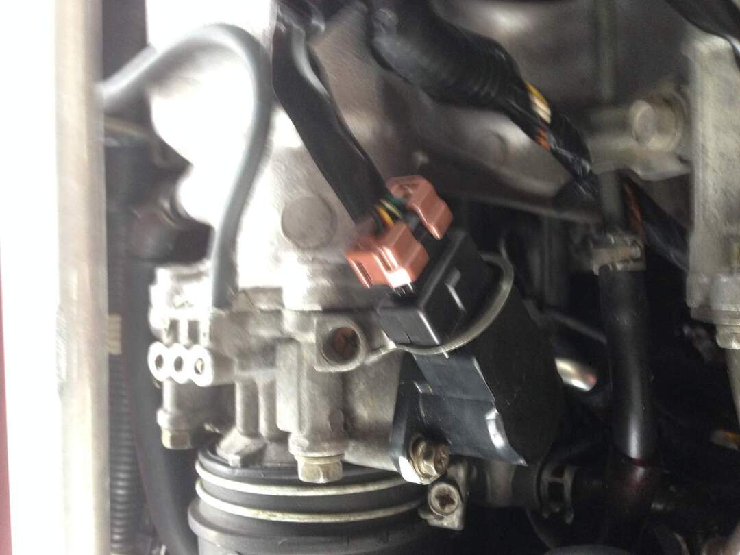

3. GB under warranty but did they say what was repaired? - The workshop didn't tell me anything. Maybe due to language barrier coz the mechanics there had trouble explaining stuff in malay or english to me. Went to the gearbox shop just now and the no problem with the gearbox. The TPS wiring socket broke (pix attached) hence the gear lag and CEL keeps on blinking on and off.

So far, TPS socket was the culprit. After adding the clip to hold it, car runs ok. I need to change that. Engine still pinging at 3000-3500 RPM. All repairs and check-up is on hold until my next salary. :bawling:
