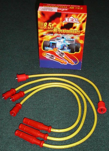

any one use this product b4?? if my engine stil standard use this plug cable got any effect(in performance)?? cos mine wanna rosak liao lo..
this is for kancil
got it from here http://www.zerotohundred.com/newforums/showthread.php?t=74913​
eh.... I can say it help to fully burn the petrol, but in performance you can't feel any diffrence..., if your car is carburetor, try to get one spark amplifier, then you can really feel the diffrence, no metter during clam hill or pick up. ^_^
For more, try to advance your inigtion timing "a bit", normal kancil inigtion timing is between 8~9 degree, you can advance to 9~15 degree. For my 660, I set to 12 degree, give more pick up and not losting top speed. ^_^

u use this brand b4?? don knw it is good or not leh.. think of buying one ... u mean these spark plug cable will fully burn the petrol rite, then that means the car will hav a bit more power lo.. rite??

i got use zaptor vs + grounding la, can feel the difference lo.. more easy to start, the car seems to be lighter, more touque,....... other users claim that the air con is cooler but i din feel any from it..
