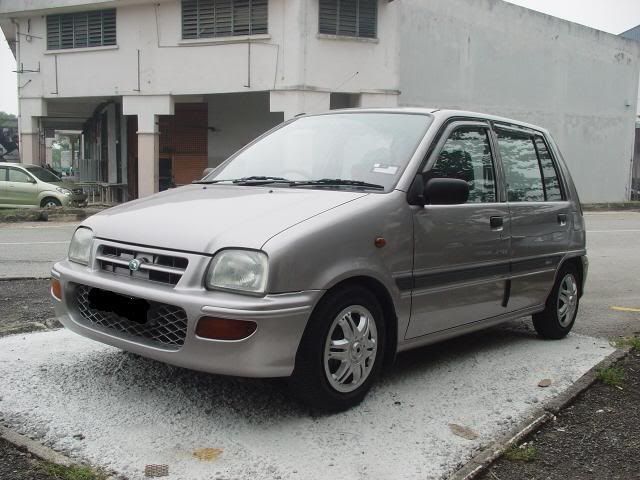

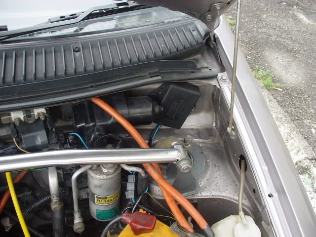

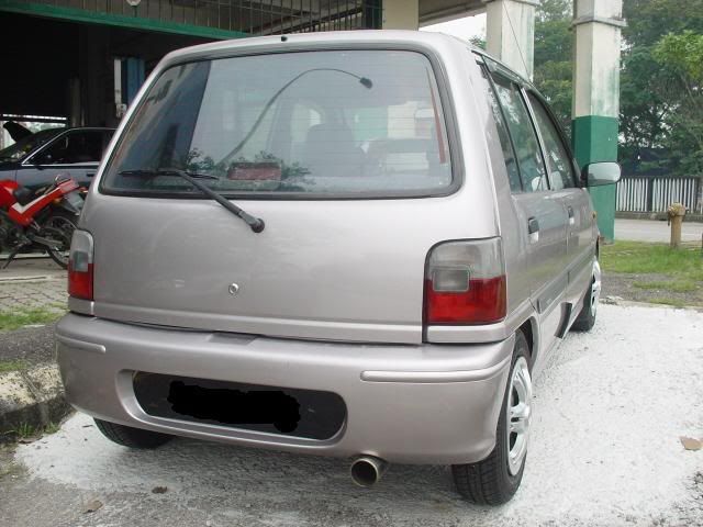

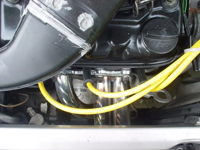

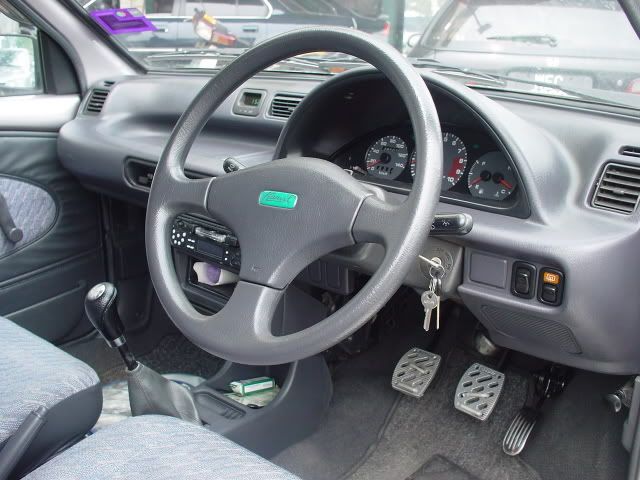

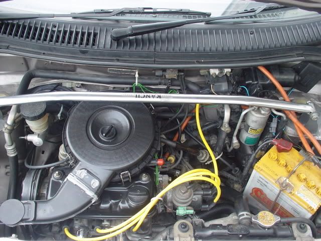

chaics, here is my car's pic, please enjoy ^_^
Front View
Rear View
Interior View
Engine Bay

Zenden extractor
