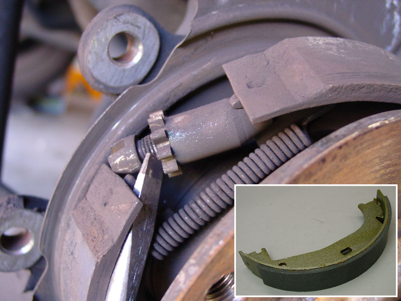

Any of you guys changed the parking brake-shoe before ?
how much per sets (left & right)
mine definitely thinner than this below pic..
I think since it is use only when the car is parked, there should be minimal wear and tear unless you drive with the handbrake on. Nope..have not even touch it since I've got the car...
i noticed that my hand-brake need to pull quite high
in order to fully lock the parking-brake.
does it means time to changed the brake-shoe d ?
or just simply go workshop to adjust it tighter (since it is use only when in park)?
noticed mine (the brake-shoe) is quite thin (compares with the 2nd pic i attached
above) when went to workshop to take out the rear disc for skimming..

If you think that yr brakeshoe is thin and you are not comfortable with it, go change it. Don't think it is expensive considering the safety issue.
Hey mike,
The drum brake shoe looks OK to me,unless its cracked or chip..change it!
The parking brake like any moving parts of the car does require some servicing...more so if the car is used as a weekend car or occasionally used.The brake dust,rust and dirt can cause it to be 'sticky'
And if you need to change be careful when ordering as there are size differences

Thanks... greytezza & 1jztezza,
will consider cleaning/blowing the dust away & making adjustment to tighten it first.
So, it means if your handbrakes can't really hold the car much and I would have to pull it to the max to lock the wheels is it consider as faulty? Cuz I was not sure if stock was lke that when I realised that the handbrakes have to be pull up to the max to lock it. My car is adi 5 years old btw.
firstly, better ask mechanic to check & see if adjustment can done.
only replace it if it already worn 'til the 'min' indicator.
