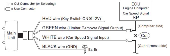

Hi all sifu...
Currently im using Blacktop Auto.Recently i hv installed a pivot speed meter...but my car O/D drive light keep flashing,so last my wireman told me auto cant use speed cut,gearbox couldn't read...so lastly i jz using it for display speed only...Does anyone facing this before?
Thank you guys...

This is the wiring diagram for Pivot Speed Meter V. hopefully the wire colour is similar with yours.
