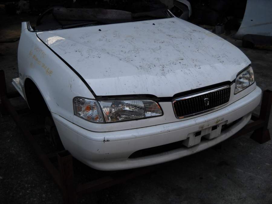

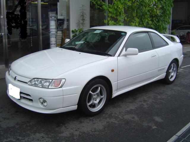

U mean all the AE111 model halfcut will facing the Super Strut System also ...but i heard that the problem only from AE111 last model (below picture)
please correct me if i am wrong.
How the AE111 Levin 1st model ( picture no.3) ?

If you using the AE111 Levin, I beat you will have 1 problem... It is suspension, you need to find it again... AE111 Levin or BZR normally was equipped with Super Strut system... Which unable to use on AE92 with PNP.
please dun get yourself confused with this simple transplant. you are not putting in supra engine into AE92. just 20v blktop from levin. no problem.
AE111 comes with 2 version. super strut, and mcpherson. with SS, you get twinpot brake. for mcpherson, its single pot. any experienced mech can easily changed the SS into mcpherson, thus u can use the twinpot and normal suspension.
kevfoo38 gave a very good explanation. others who may have not done it before might give you confusing answers to your simple questions.

AE111 Levin/Trueno was normally come with super strut, no matter early or late model... But some are with McPherson setup too, and it not much...
Anyway, I was talking the SS suspension issue only might have issue due to need to use back original or change another set ony, but not the entire brake system. Hopefully don't misunderstanding my poor English le. :rofl::rofl::rofl:

bro,some correction on your remarks,
all 6 speed levin/trueno bzr comes with superstrut systems as standard,
so does most of ae101 supercharged ( not sure whether is standard spec or not)
macpherson is standard for:
ae101, 5 manual or auto
ae111 corolla gt and carib wagon (no matter auto/5 speed or 6 speed)
ae111 levin auto and 5 speed manual

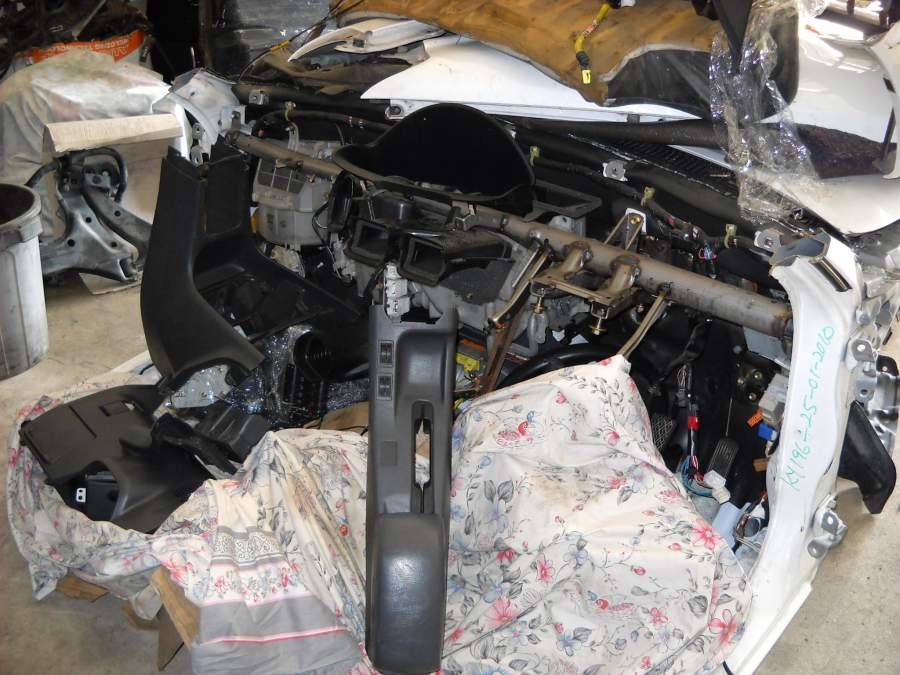

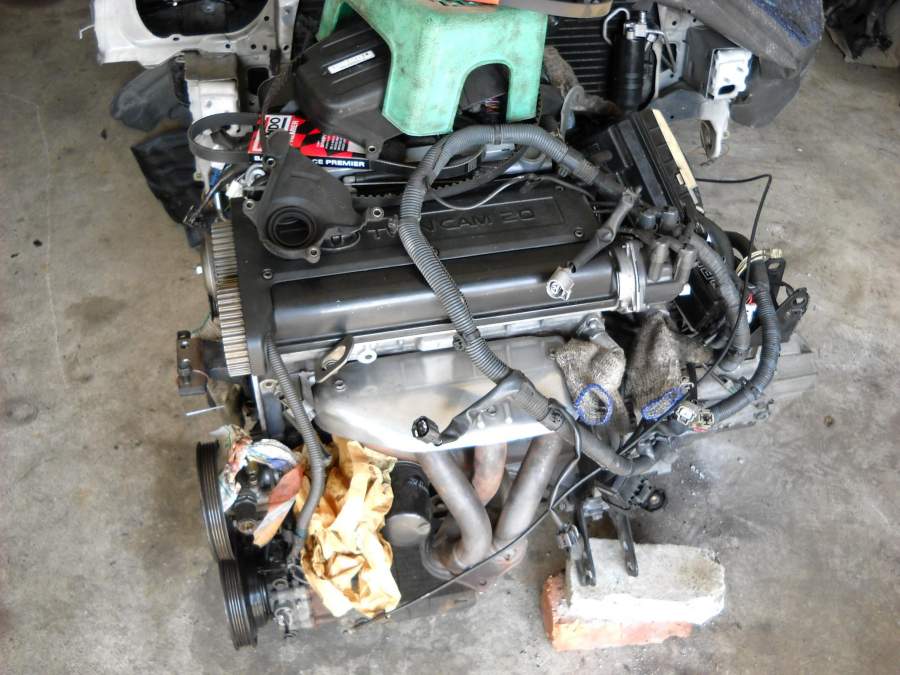

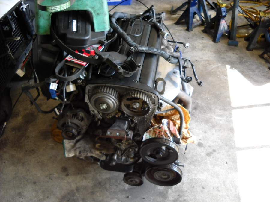

i just bought a AE111 corolla sprinter halfcut (6speed)....after CYN .....will be start my project T to EE90 body...
