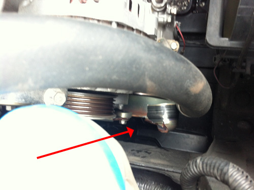

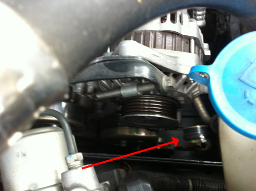

This morning while driving suddenly I heard something weird and my battery indicator turns RED.
Open up the front bonnet I realized that alternator pully crack. Send over to Honda SC to rectify the problem waiting the quotation. Model Honda City 2008. Out of warranty already. Any idea is the cost.
I am not really sure the crack is from alternator pully or aircond pully. Pls advise urgent

looks like the alternator pulley is intact and in good condition tu, i guess dat shud be the aircond compressor pulley sir. get a new one from the spare part shop if the car isnt covered by waranty any more, or u'll spend a hefty amount if rectified by the SC imo
Does it comes together in one set alternator pulley and aircond compressor pulley or separate set? Roughly how much is the price for the aircond pulley?
u can just get the pulley jer, i cant estimate for a honda, but shudnt be dat expensive imo.. just get any pulley with the same size and dimensions, or better yet u bring dat broken pulley as a sample to the shop to avoid confusions

Honda just called me. Total cost is Water Pump Pulley - RM22, belt RM55 and labour RM55. Water pump RM22??? From the image I assume the crack is the cover of the pulley? Do you think so?
