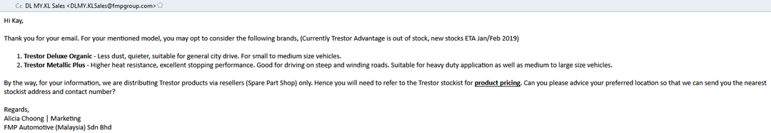

Got a reply from FMP Malaysia.
Looks like I need to wait. :0
Sure is 'Pisang Panas'

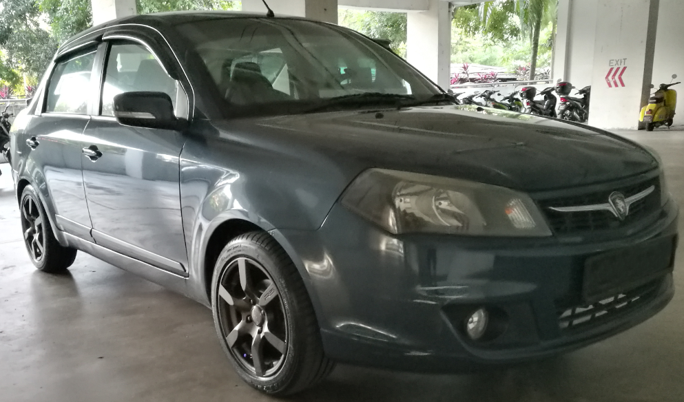

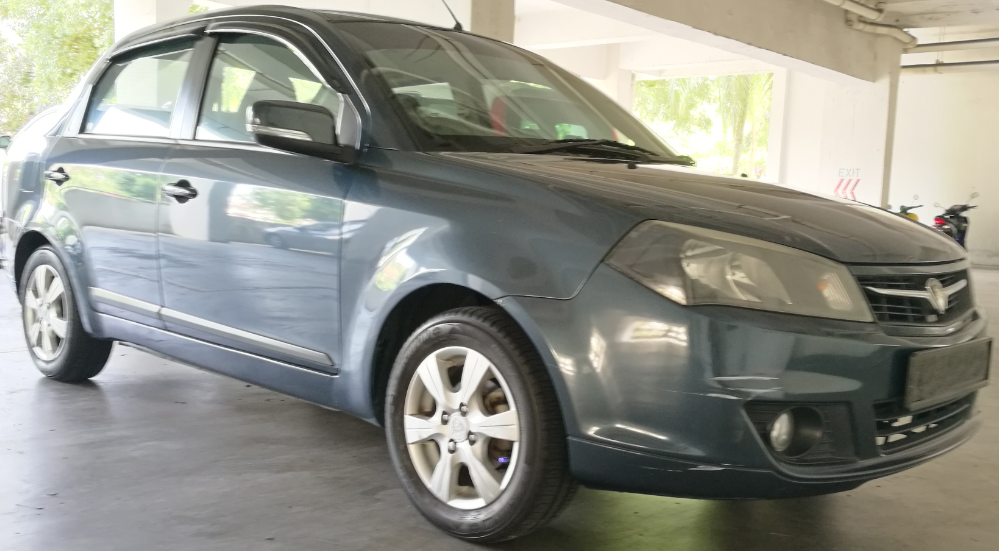

no you just need a proper adjustable or lowering springs. :driver:
your rear looks lower than the front based on how the tyres tuck into the fenders. is the suspension still ok?
Maybe Optical illusion? FWD have wider front track....
