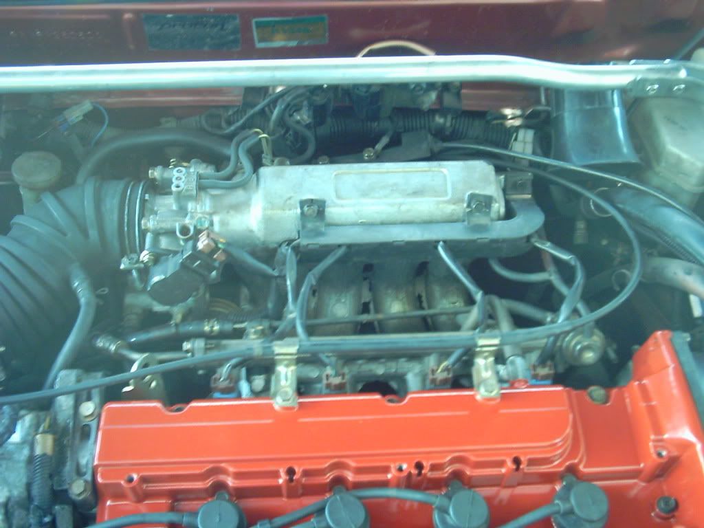

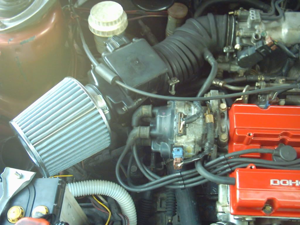

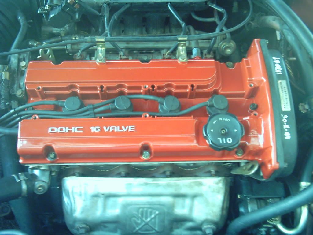

project done
here u are:
fuel consumption will be updated as long as i get the data.
the mechanic has changed the distributor,air flow sensor(1.8cc) and also the whole engine head.cost me RM 1430 for the whole thing.
RM 30 for red painting,RM 1200 for all the head+air flow sensor,timing belt,timing belt cover,distributor+etc all the parts that required.another RM200 for engine oil(RM74 already)spark plug,valve seal,oil seal+blah blah blah.
the power i think is in between the 4g91&4g93.

it's looking nice.. but use ferrari red lah. more shock. ur rpm will it become not suitable? something like twim cam, cos u havent change ur manifold and TB. last month i also going to change to twincam head but my foreman give some bad comment so tat's y i stop my step. haha. but after saw ur engine and hear ur feeling, seems like good. got a bit gatal liao.. haha..ok. good luck man.
kob3bryant , your engine pic make me so impress because i had found a new way to mod my car ler.. i own a 4g92 1.6 (m) also with sohc after saw your engine pic damn.. i love it like hell because of the dohc head... because i crazy for dohc engine for long time already... ur pic give me new insight....
ok after your sohc to dohc conversion... the gear box and clutch still able to support the power? or after you trying your engine got feel any spin on your cluth or not??
ok after your sohc to dohc conversion... the gear box and clutch still able to support the power? or after you trying your engine got feel any spin on your cluth or not?? and you change your throttle body also? because i saw your throttle body was diff with mine one.
chimeara;
wat is the diff of ur t/b with mine?care to let me hav a look at ur pic?the clutch is not spin,but the wheel spin.it is much more easier to rev by now,i will time out my 0-100km/h record tis afternoon after break.will update to u all,even though it may not be accurate.anyway...,i juz give it a try.
