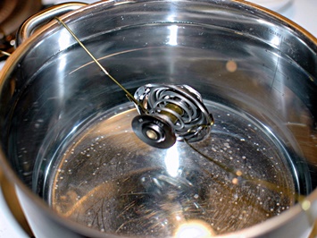

Agreed. The chances are low, but it is possible the thermostat is faulty, even if it's a new one. You can take out the thermostat and do this test. Hang it in a pot with a wire, make sure its fully submerged with water. Just tap water will do. Then turn on the stove and watch the thermo slowly open up. If it doesn't, or open partially when the water boils, then its faulty.

A good test. But, I don't know how to take out the thermostat in my car.
