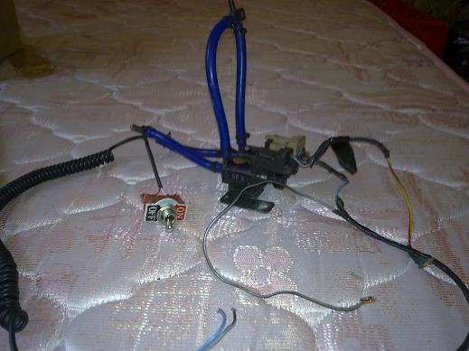

DIY Dual Solenoid Boost Controller + trigger switch.... :driver:
murah2 saja....

Most MBC will spike 0.1 it's normal.
That's how you tune it anyway, set the value you want to spike to and the constant value, normally like spike to 1.3 settle at 1.2.
