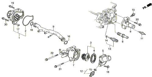

i kena last sat this 'water pump pipe' located behind the block
slightly beneath the intake manifold bocor due to errosion...
when hot, the fluid doent even hv chance to drip as its 2 hot
& it became vapor immediately... producing this boiling kettle sound
inside ur engine bay.
b4 this my problem 's juz like yours... coolant fluid gone 1/2 to 3/4 cup
daily... so be wary hondarians...

3368,
hehe..what diagram you actually need le bro? hows your 2L going so far?
J101 said:
3368,
sorry bro late reply my pc sot oledi (overclocked wannabe) i mean that diagram that you show in this thread (the pictures tuuuu) every time i wanna find parts i have to shoot up 45km away just to lend this diagram book from a autoparts shop write the parts number and order in kl.
