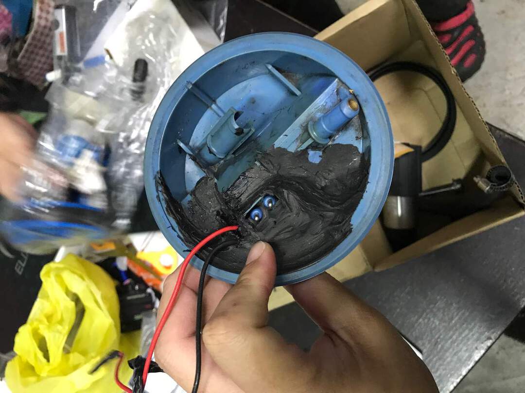

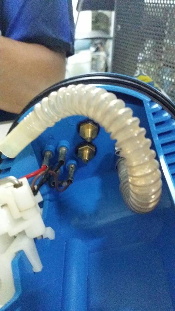

Shoddy aftermarket pump mod work. Whoever did this short-cut through the proper installation procedure. So this had to be redone.
Silicon is not petrol friendly! Jeez. And that rubber hose is not a pressure hose!

Dunno who thought it's a good idea to seal their shoddy wire install with silicon to be inside the fuel tank.

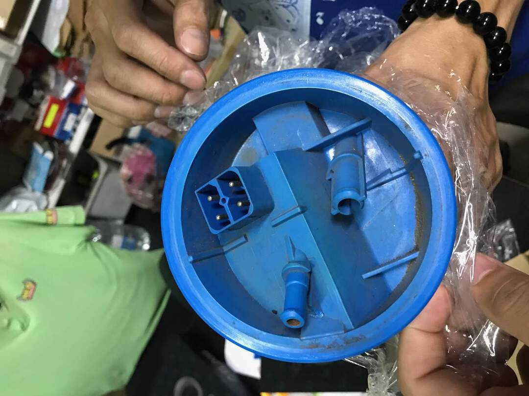

I had to buy a new one. RM380.. sigh.

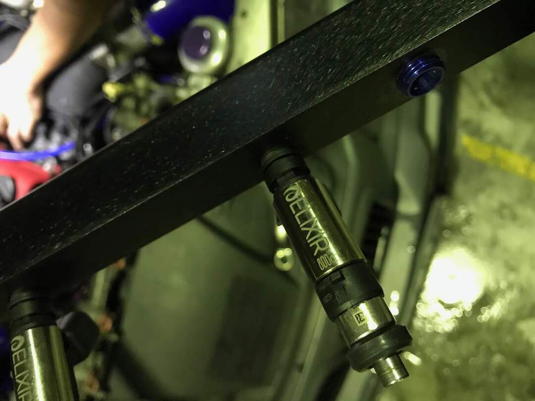

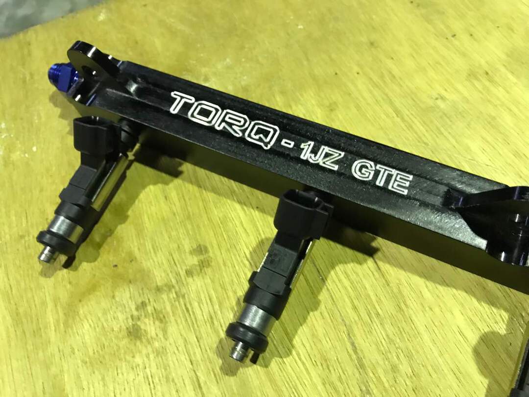

Took this opportunity to update the fueling system to more modern top feed injectors and high capacity injectors and fuel rail.

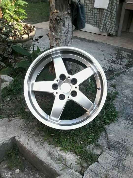

And I now have a pair of BBS RC 17" original rims for sale if anyone is interested. Cuz I'm going to swap to these Hamman H2s.
