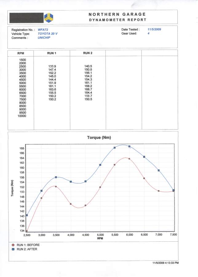

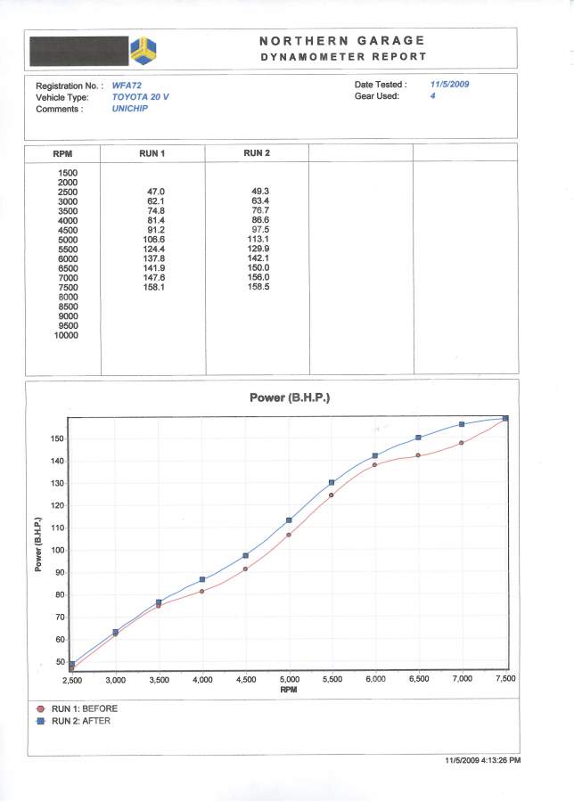

finally my BT conversion is done.
when to dyno & tune at Nortern Garage.
setup:
1) stock BT Engine
2) Using Ron95 petrol
3) stock plug cable
4) Open port Apexi filter
5) Sars fuel regulator
6) Custom piping 2.2" with lousy S-flow muffler
7) iridium plug
8) Idemitsu 10w/40 already run 2000 km since conversion
9) Piggyback Unichip-Q
The dyno graph based on 4th Gear
only able to get ~158hp (Engine HP) and 168Nm Torque.
any one can advice/comment did my stock engine look healthy ?

Very surprise to see this figure with Ron95. It's healthy. Ask William for my graph, it's there for you to compare.
