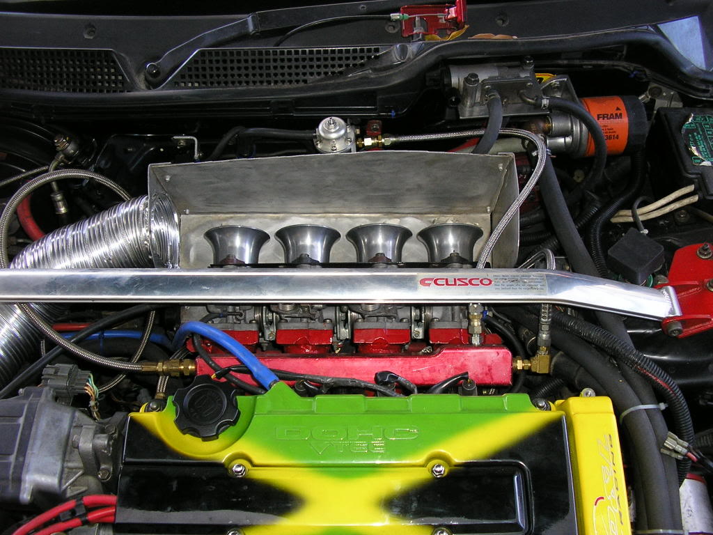

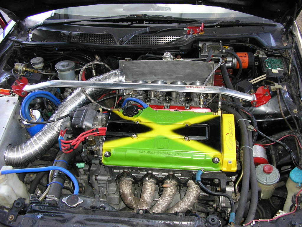

and if u wanna put trumpet.. do it like this..
it's not a toyota.. but trumpet = trumpet = trumpet :biggrin:
