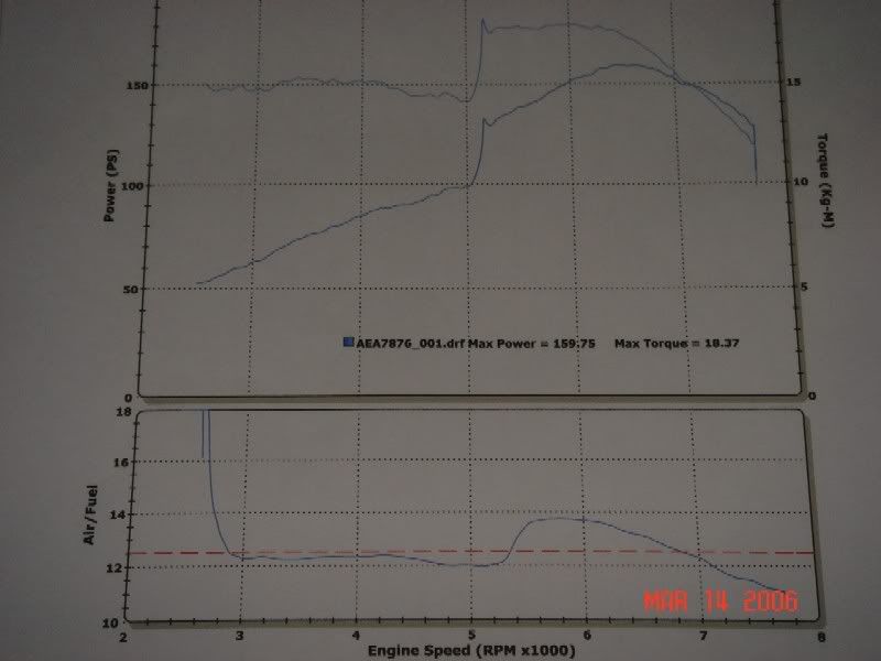

Just to share my mods on my 1.8 Mivec:
1. Port n Polished Mivec head
2. Enlarged t/b
3. 81mm Mivec pistons
4. V-AFC + ITC
5. Custom Mesh Filter with OEM airbox
6. Aftermarket 4-2-1 (dunno wat brand)
7. 2.5" ori route piping + 2.5" HKS muffler
8. Arospeed cam pulleys
9. NGK Plug Cable + NGK Iriway 8
ermmm, tats bout it i guess....the rest of the minor2 mods are pretty insignificant in hp gains tho........the engine was tuned more for response n torque rather than outright hp......a/f is abit crap at the top end....cheerzzz =)
Dyno chart
