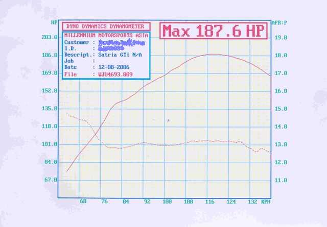

I dunno, but is this a common thing with 4G93 1.8 MIVECs?
I ran such setup in my GTi. B4 my ECU was properly tuned, I experienced pinging too, but was somewhat fixed with whatever magic they work out with the computer lah.
But if you still want, I can share my dyno results. IF you want.
Post your dyno results too bro
Me? uhh, anyway, nah. Enjoy!
From a 1.8 MIVEC. as the topic sez, this is wheel HP.
I think I post b4, but can't remember.
