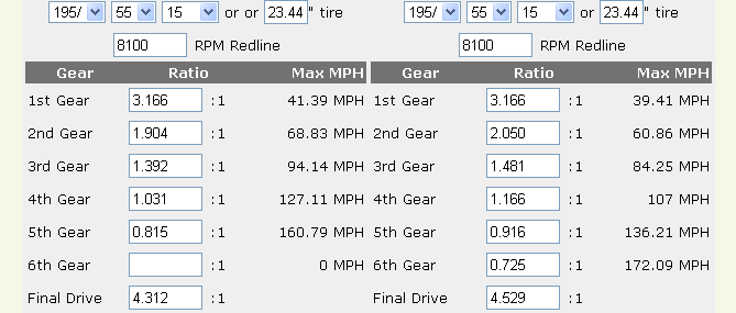

6spd is darn good for acceleration, not too sure about top speed though. IIRC, 5spd can do almost 180kmh on 4th gear.
Another point to take note is that almost all 20V race cars uses 5spd only. Apparently 6spd is not so good for trackdays.
How about hybrid? Anyone tried different final drive gears on 5spd & 6spd? How about using 6spd final drive on 5spd? I heard some hybrid 5spd gearbox can achieve impressive results!
