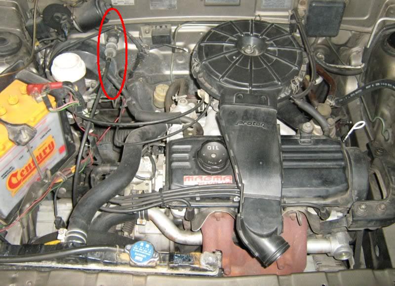

1) check the freeplay on the pedal, may need to be readjusted. Its easily done, look near the brake servo and you'll see the clutch cable to the right of it.
Google images is your friend. :biggrin: pull on the circled item, then u can turn the nut there to adjust.

Clutch pedal freeplay should be no more than 1/2 an inch. If its more, tighten that nut.
