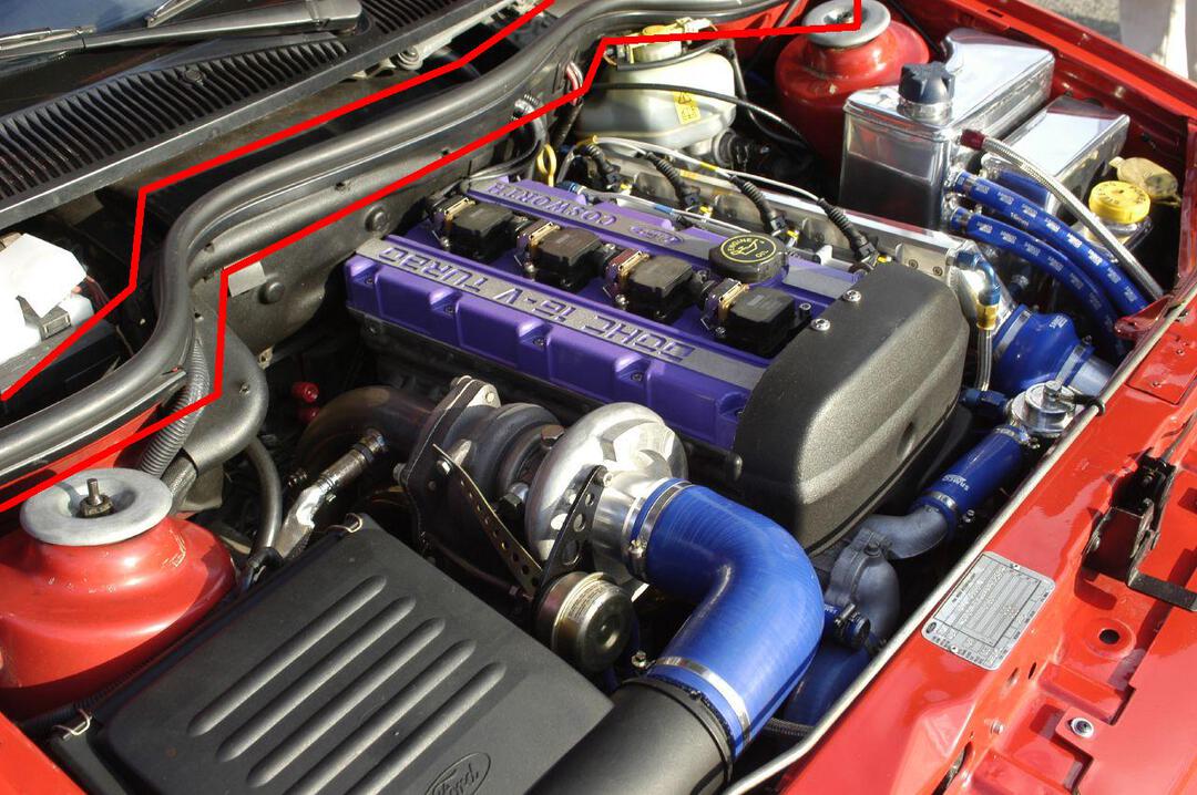

3- Remove the wiper cover rubber as in the redline in the picture. It will make better air ventilation.

The rubber is higher up, water will drain into wiper motor area. Maybe some water will still splash into engine bay, but more actually comes in from the front and from underneath and most splash up by the belting....
