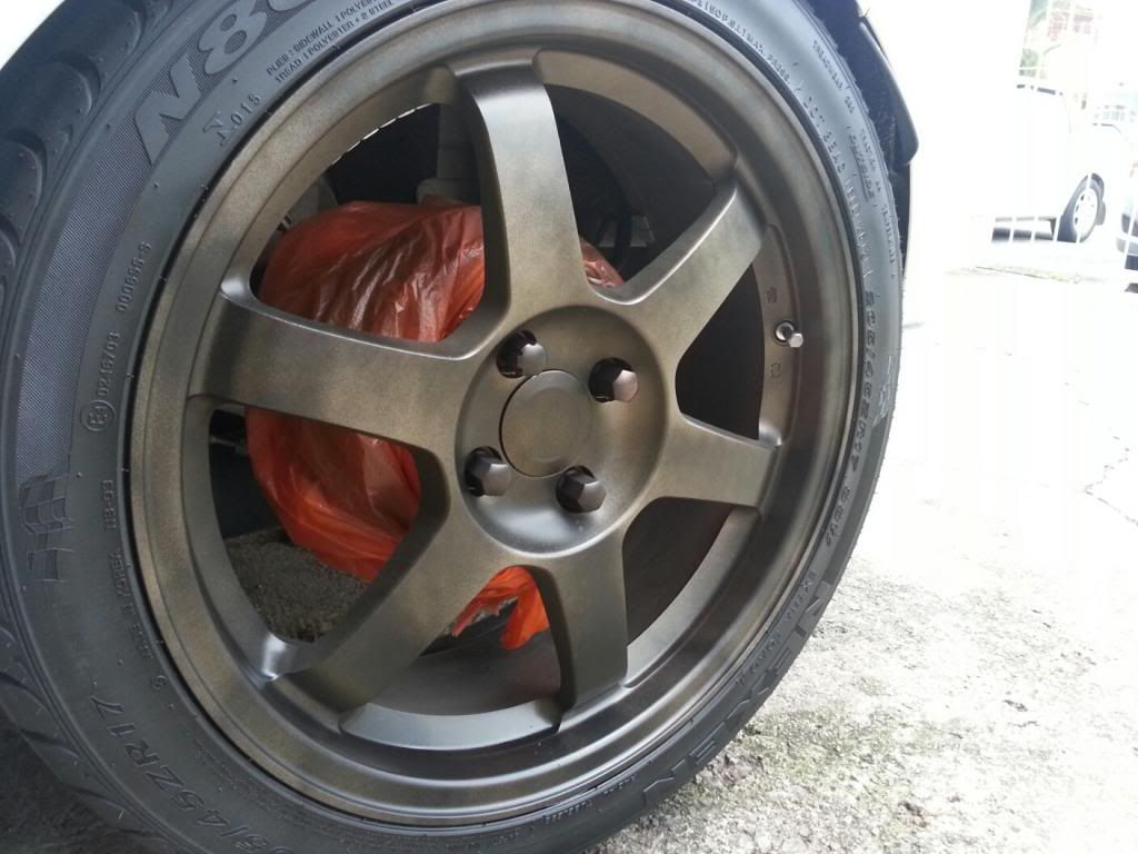

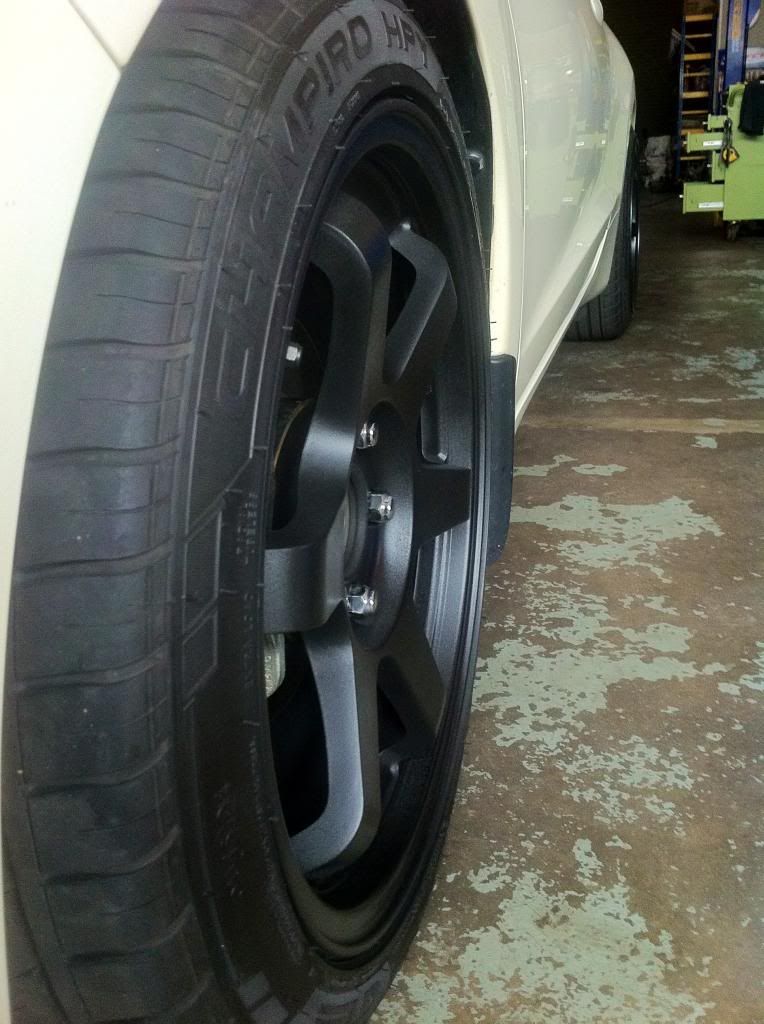

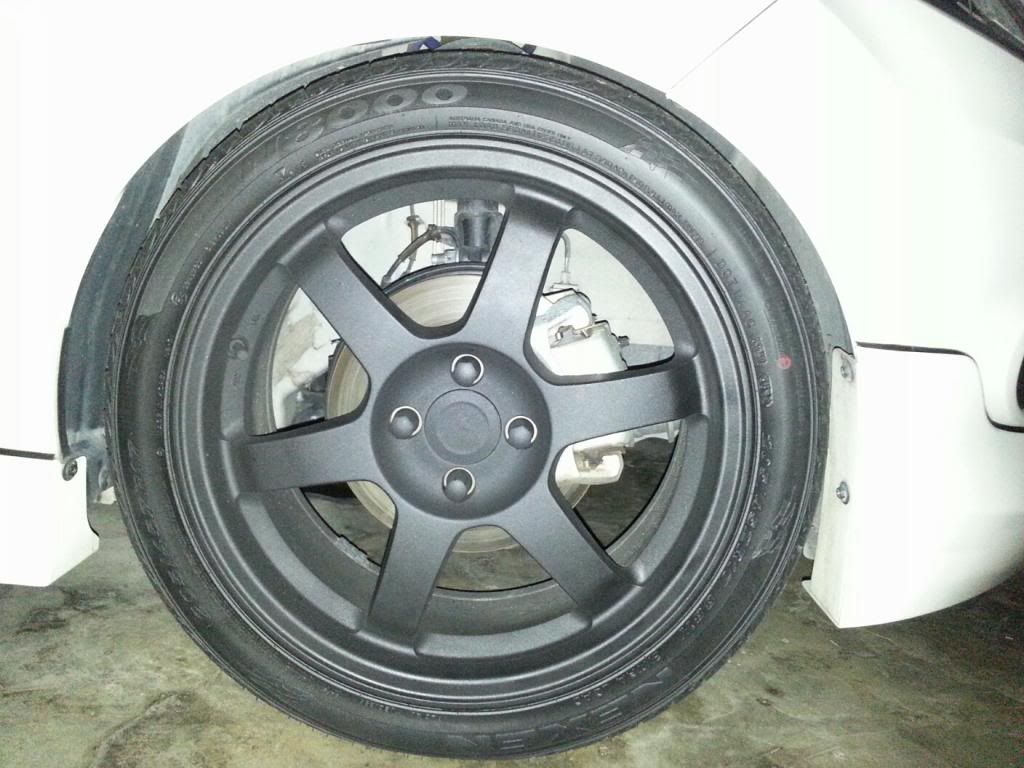

i changed edi bro, 17.9jj et 30 rear n 7.5jj et 42 front....running staggered setup. Gonna dip the fronts.
What's the spec of your old rims? still with you??
I mix front and back with my friend. Staggered setup Front 7.5j Rear 9j.
If front 9j, it rubs the fender cuz the offset is too outwards
Oh..I thought you want to sell your old rims....interested that's why i asked..
Yeah, i thought of selling also but seems the front is too aggressive for my liking so since its the same design i can keep 2 front ones and widened the rear only...i like how aggressive the front looks but have to do fender roll and pull and remove the lining...For a new car i don't think i wanna do so much just to accommodate the wheels. so the most okay solution is to stagger it...now looking for 5mm hub centric slip-on spacer

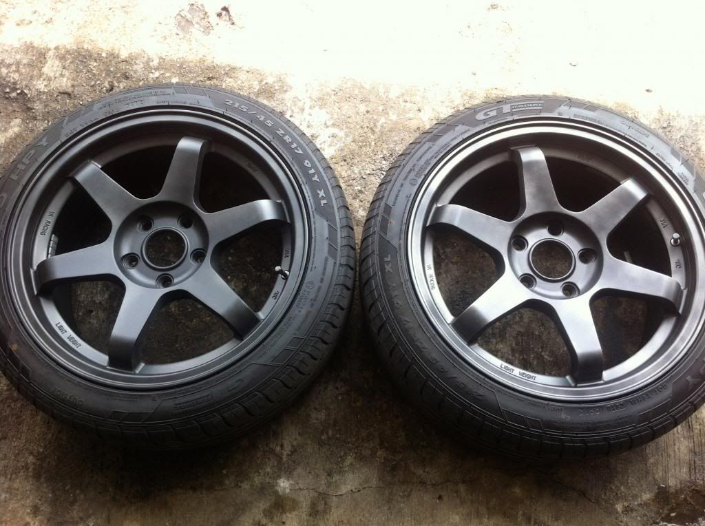

On behalf of Infinity.Melvin, here are his wheels

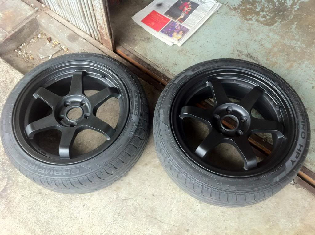

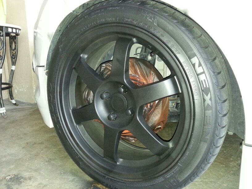

And here's my DIY yesterday afternoon
IMO, easier to spray with wheels off but with wheels on you don't have to jack up the car...whichever more convenient.

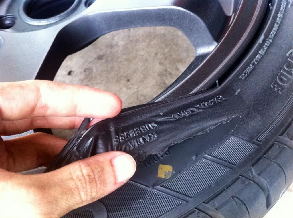

After the rubber cures in 48hours, it should mould to shape and hardened. Kinda like a sleeve or heat shrink and will be semi-permanent. In U.S, the dipped wheels may last up to 2 years with minor stone chips. Depends on driving habits. If you decide to remove it, you can apply a lil force and it comes off all at once. Treat it as though its a colored protectant, insulates and rubberized your items

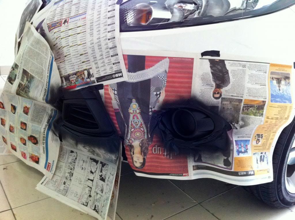

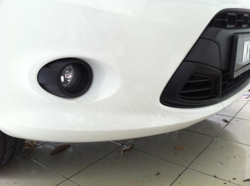

my customer requested Dipping his grill,emblems and smoking the taillights, left out the foglight chrome rings for later. This was all done before a total 22PLE Ultra Hard Glass Coating
