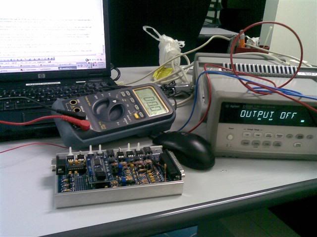

Here is my assembled ms board and tested to be ok, but still no have time to install it in my car, innovate kit also no yet ordered it's a kind of expensive for me, too bad
hurmm gud to knw more people running MS..keke
