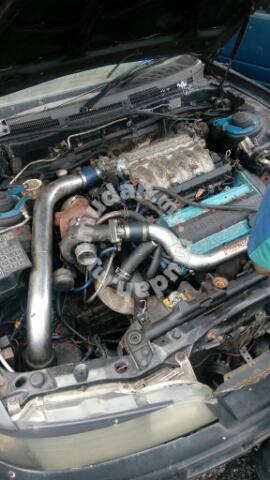

Saw this in sale on Mudah..
Was wondering worth it or not.:confused:
can it actually start? whats the price/link?
anyway, single turbo
pros:
-less mechanical failure since only 1 turbo vs 2 turbo.
-better power
Cons
-piping would be costly
-mechanic willing to service the engine
pros:
-better power
Cons
why not go for evo?
