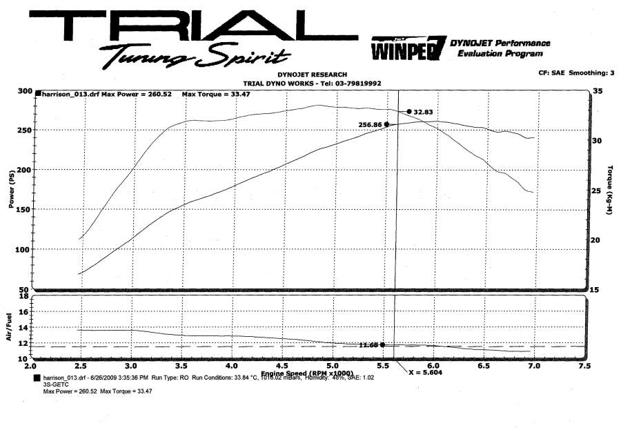

Hello guys..
Final thing to post up after my engine transplant........
Went to Dyno at TRIAL after 1 month of problem free & running-in driving, serviced, oil filter & spark-plug changed.
Spec.....stock standard boost 0.7bar, TRD drop-in filter(from my old 3S BEAMS engine) & 60mm straight-flow exhaust system.

fantastic engine hp and torque...... even this is not a new engine but still can provide this kind of power really salute Toyota and Alex works..........:adore:
porosan; strange the power is peaking @5500 rpm what with the 4.3 final drive.Should come in earlier at least around 4000-5000 rpm when the vvti kicks in.What gear used for the run???

soli dunno...that never cross my mind at that moment :hmmmm:
cause was :confused: when i saw 260rwhp.....
