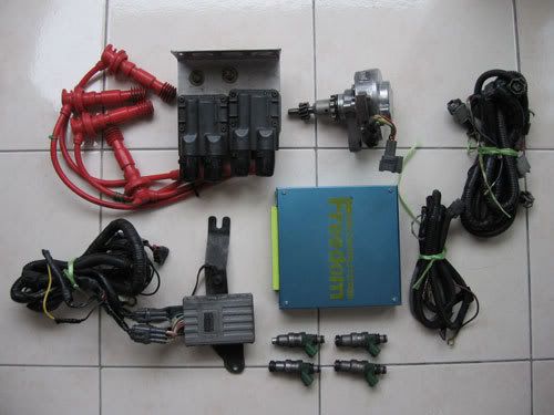

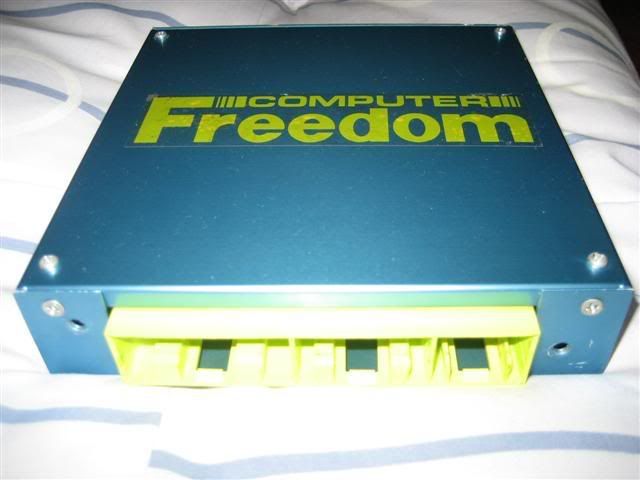

maybe you can get a used Freedom and have much much much much much more flexibility in tuning and able to gain more power from it.
PM me if you interested in Freedom ECU for 20V.
Please refer to below for Freedom ECU for 4AGE. Plug n play unit.
Below unit is the Freedom ECU with optional funtion which can run waste plug.
Below unit is for AW11, AE86 and AE92. Wiring modification needed for below unit.
