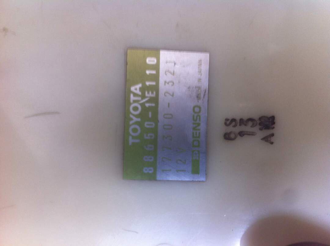

Ya only left with the ac control unit dint change, coz have mention before the correct model my forman don't have.
As he mention he only have the levin type model my should be wagon type which is the show in pic.
