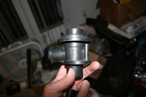

this is how a HKS recirculation kit looks like , so it will make the ssqv a PBV
http://www.gpiperformance.com/images/HKS-Recirculation-Kit.jpg
a stock car doesnt need a aftermarket BOV unless its 20psi n above, tht is totally wrong , an example an evo , from experience n fact , an evo 1,2,3 PBV will leak aprox 14psi , the later evos have much stiffer spring setup , the evo 8 MR has a steel body to replace its plastic PBV's , the old school vr4's has much stiffer PBV compared to evo1,2,3
evo 8 stock plastic PBV
stock evo9 PBV
so it really depends on the car n engine model to know wht PBV it has and how much it can hold , but ALL PBV will be able to hold stock boost with no probs, anything greater would depend on its model n make
so here comes the topic again , the aim you have here is COMPRESSOR SURGE which causes the flutter, so in other means, regardless its PBV or BOV , it will effect performance and lifespan of the turbo.
here is a DIY airticle by the gurus on how a stock 1G Eclipse PBV was crushed to make it achieve hold more than 13psi
1G BOV 101 / Mods - DSM Forums
so the topic here is i really want to know is it
"BOV NOT NEEDED" or is it "I WANT COMPRESSOR SURGE SOUND"
because from your first post , the intention is to have compressor surge sound regardless of BOV or PBV :)
if you are meaning car doesnt need BOV because it already has a PBV, then err i guess the topic ends here, cos all of us over here know that for a fact , every petrol turbo car will have a PBV as stock and it can be replaced with a aftermarket PBV or BOV if needed. Err im still confused, so wht does it got to do with the Flutter sound, err thank you. *confused*
to know more, why a stock car is not fitted with a BOV instead of PBV, it relates to Airflow sensor vs Map sensor fitted cars , enviromental issues and etc :) , i guess tht has been discussed in the other threads already.
