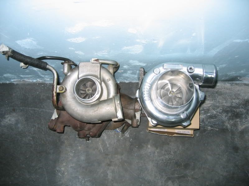

turbos for evo 7 n above...
stock vs gt2835
gt3037 vs gt2835

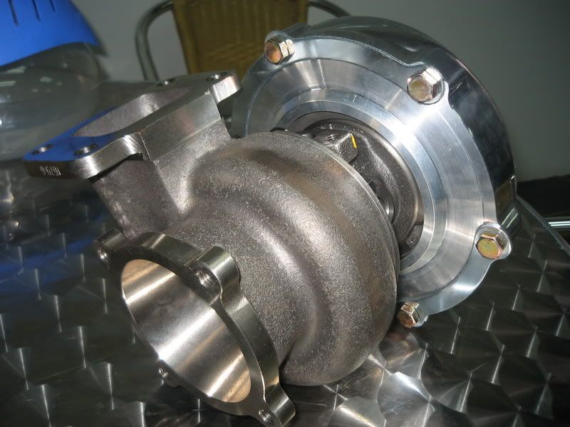

DD:apexi rx6 full kit will easily cost u 20k above.the turbo itself is a ball bearing from ihi.the wastegate got coolant passage and not the turbo.hks gt3037 full kit cost around rm24k if not mistaken.and hks gt2835 full kit cost rm17k.and it come with internal actuator system.all cucuk dan main:regular_smile:
and the garrett turbo that Turbo One selling come with turbo only,no exhaust outlet,oil and water hoses.u have to fabricate yourself,wont cost much.less than rm1k for all.they selling the manifold for the gt3037 to save all the hassle to leave your car to someone else to fabricate the manifold that will takes long time.bout the price u have to call them to ask,mana tau he give u a better price if u ask a girl to call:X-: juz jk

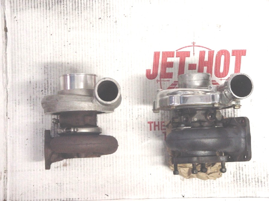

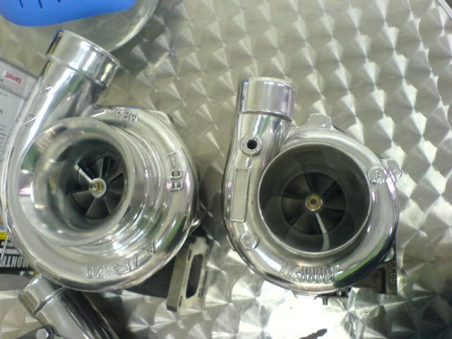

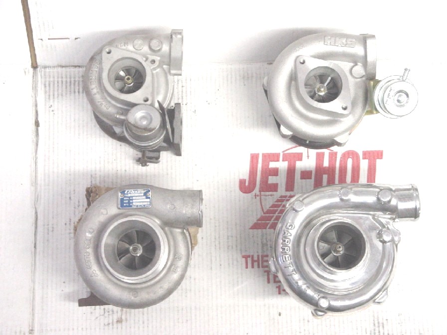

[FONT=Arial,Helvetica,sans-serif]Compressor side: Stock vs 2540 vs TD06-20G vs 2835
[/FONT]
[FONT=Arial,Helvetica,sans-serif]compressor outlet: TD06 vs 2835[/FONT]
thanks JINKL !! but only the 1st pic can see the rest can see le.......can post some pics of the header n turbo of gt30R n gt35r ka :))

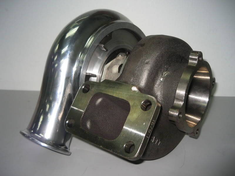

would anyone like a Mitsubishi T88-34D...
we now have ex-stock..
http://i94.photobucket.com/albums/l116/supervr4/Picture481.jpg
http://i94.photobucket.com/albums/l116/supervr4/Picture477.jpg

bro....T88 is ball bearing as well ??? how much horspower ? at wat rpm start spooling ? do u have any info on turbos as in when they start spooling n achieve full boost ?
DD...come and see urself.... no point tellin u in words in the forum.. ;)

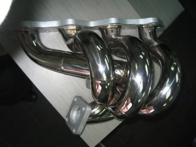

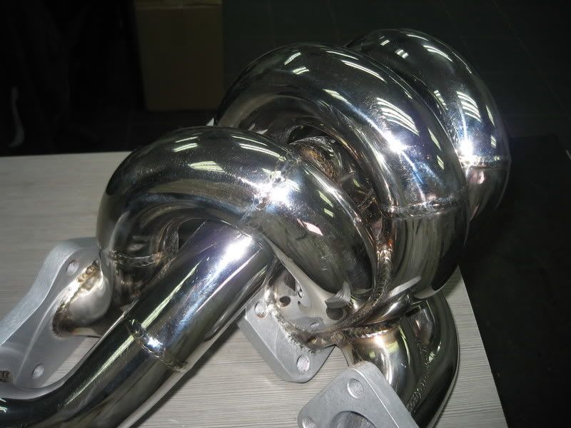

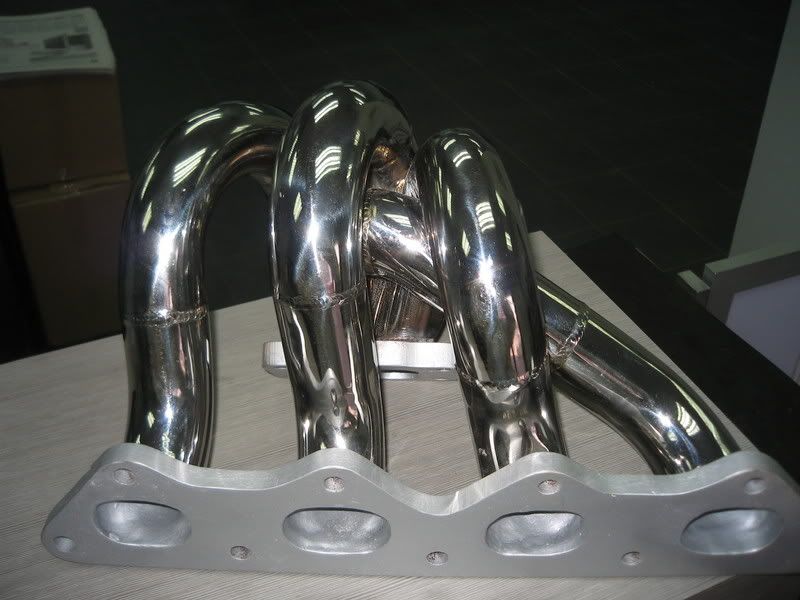

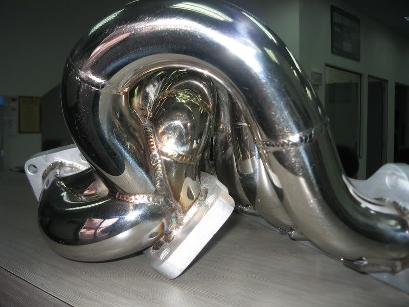

yeap thanks bro jinkl n lan evo, yeap the info is very very true.....but bro ....i got 1 headache...i dun mind to upgrade to gt30r.....but i had a wastegate header which is fitting on my current stock e7 turbo......n i do not really wan to change header again....is there anyway for the GT30R flange to be changed to fit my current header flange ??( it is a stock flange for stock turbo)
any ideas or comments ...plsss
DDgrey : tht makes life simple , u just need to remove ur header , cut off the current flange n redo a new flange, do with a experience exhaust shop like ah lai , jian hang or robert , bringing the turbo together is the best way, so they can adjust it properly.
DD:get the manifold along,to mod the stock header to fit the gt30r is impossible.because of the offset entry of the stock turbo flange.is not as easy as jin said.if u extend it then the turbo will sitted too low,u will havin problem for the intake pipe,and the turbo will be too close to the radiator fan.kena sini kena sana.u see the pics of the manifold sdf posted.and compare to stock manifold.u willl know wat i mean.i try to upload some pics to show u but internet damn kao lag cant upload now
thanks jinkl bro....u gave me hope....thanks lan evo bro....u said out my fears.....sigh.........i was actually aso thinking of doing a flange cut.....anyways my header is not stock header...its a customised product with wastegate extension ...to fit the current stock turbo.....reason being earlier i wanted to change away the actuator setup...........
as for the length as compared with stock header.....i m not sure if its longer or shorter......was really hoping by doing a flange cut can solve the issue.......
bro jinkl can u guys actually do a correct measurement b4 i buy the gt30r ? just trying to minimise on cost....since i had the header done not long ago....n i kinda like the header a lot....its done with very tough material
