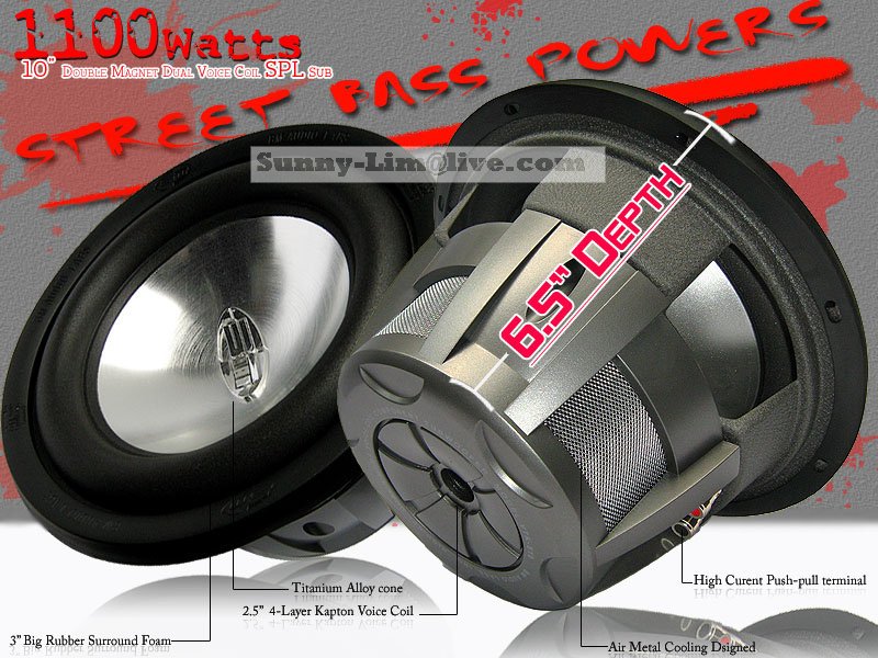

i found this. boschmann sub. got detail info.
n i look the actual sub liao.
damn heavy.. the acc shop guy said 1 enough. if 2,, wan blow bonnet ah.
tis sub can pakai or not ?
donno the amp can tahan tis sub or not. got 2 +/- wire terminal . can set as 2 ohm.
the guy told me.
the specs of the sub doesnt clearly say what power RMS it needs, just says 1100W power handling, which i assume is peak power, maybe its around 400-500W rms
anyway its a dvc 4ohm sub, so u can wire it to 2ohm via parallel wiring. u will get 600W from your amp, which i assume should be ok for this sub
