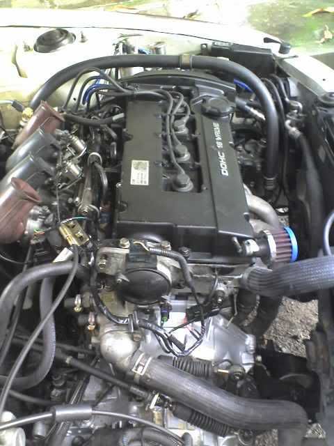

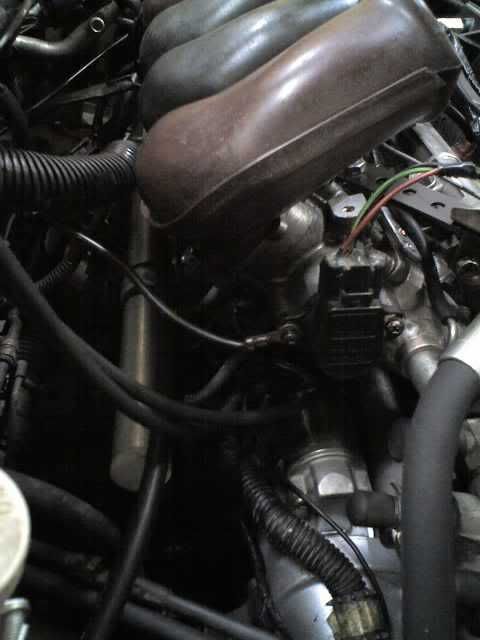

just showing off the vacuum canister that some of you been asking about.
here it is, its the long aluminium tube under the intake runner

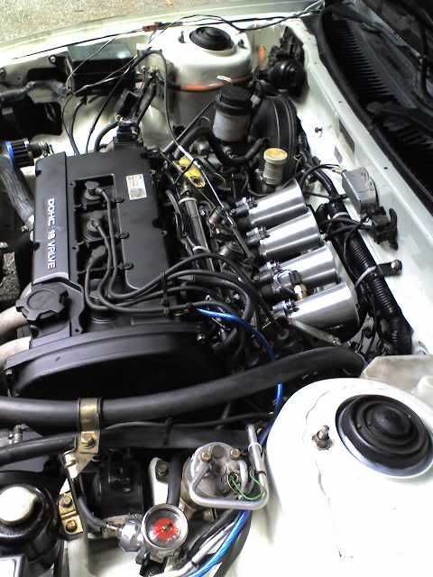

and the latest pic of my engine bay.. not as messy as b4 eh?:tongwink:

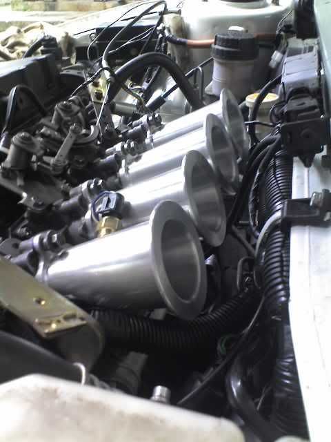

it took 1 day to complete my intake runner.. nice n shiny it is.. but sadly,.. no pics of it yet.. it was late already, my camera has no flash!:cry_smile:

in the meantime, enjoy these pics!

leftfoot, your engine bay looks much much better then before. So your not using any filters?
