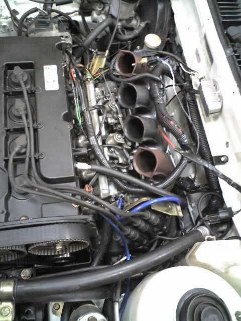

using mivec, cam spec as follows:
duration low cam lift
intake 228 7.58mm
exhaust 232 8.24mm
duration high cam lift
intake 285 10.41mm
exhaust 300 9.83mm
Using high compression 0.4mm metal gasket.
Hmm.. what total runner length u think is suitable for my cams?
red line is 8250, maybe i can push to 9000,.. but i'm not going any further than that. so the powerband i want is a good swoop around 4.5-9k
hmm i shall experiment with a pvc runner first b4 attempting to fabricate real ones
