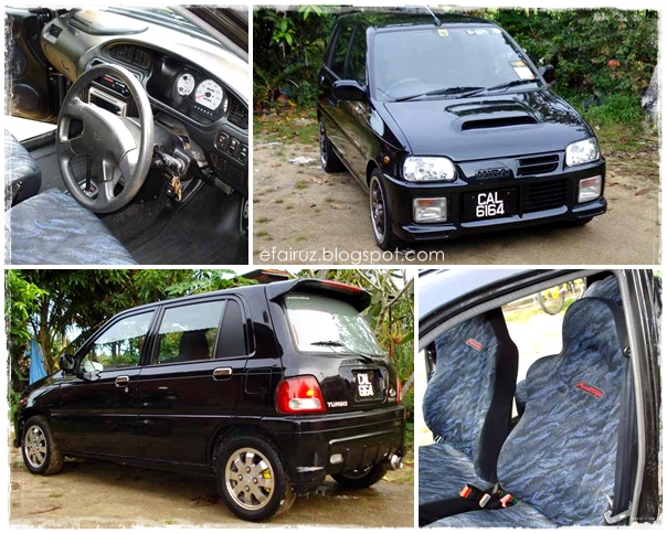

Btw, I actually like this bodykit. Simple and nice. Won't get too much attention. Minus the scoop.
attachment.php
this is mira parco if im not mistaken.. mira J also looks low profile..
Ya parco IINM. Mira J and Parco is the one I like. Low profile. Simple and nice.
Actually like the L512 Bodykit but that one JPJ sure stop. Only the front though. Rear not really like.

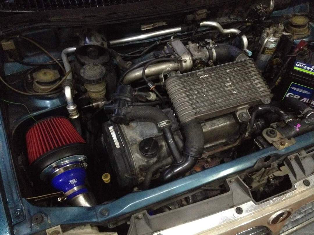

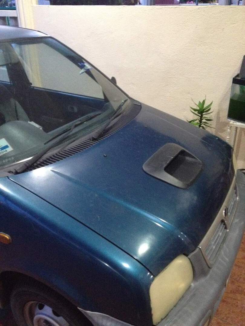

As promise guys.
My humble beli sayur kancil photos.
Engine bay, speedo and the humble scoop on da hood. =)
P/S - Please help me to identify my engine base on its outlook. It should be a L5 right? Hahaha

this is definitely EF-RL since its a twin cam 3 cyl with grey colored intake manifold.. but not sure from L5 or L6 or L7 or maybe L9..

Anyway nice, that u have a EF-RL in your car. :top:
I think it should be a L5...my guess is also EF-RL... Now I have the answer. Thanks sifu. =)
