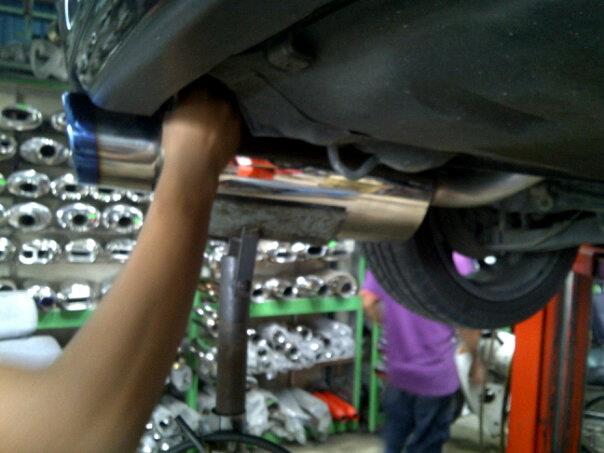

Done with the muffler, now using a 2.3 inlet muffler with a slightly bigger silencer, slightly better pickup at lower RPM compared to the old one, old muffler picture on my first post. Changing the extractor takes alot of time, so decided not to do it for now also quite costly.
sorry for the blur image, took from my friends phone.
