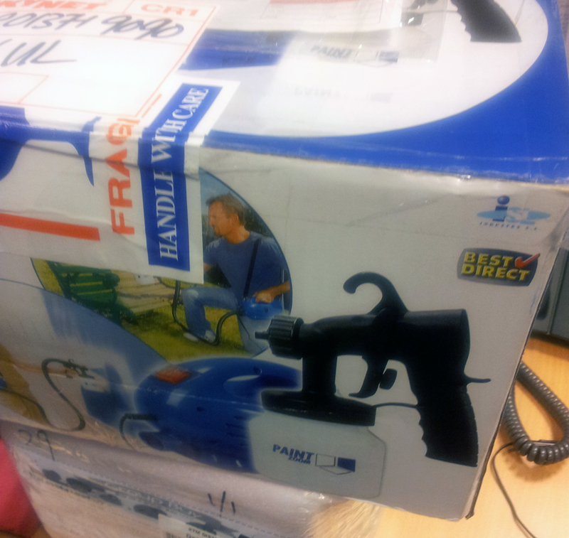

Izso, what the hell is that? using compressed air or pump-up action sprayer?
Short mini projects, not for major respraying.I saw Ace Hardware got Xylene rm60 1 gallon. If you can get naptha it's better as mix thinner since naptha dry faster than xylene.
Becareful with the spray gun compressor,the motor of the compressor will get hot and will burn your body while u doing spraying.Do tape the hose connection of the compressor and spray gun coz it will come out easily or i can say spoiled easily. I throw mine away coz it's sux and get a wagner hvlp gun at rm500 from hardware shop.
Electric paint spray gun!Short mini projects, not for major respraying.
