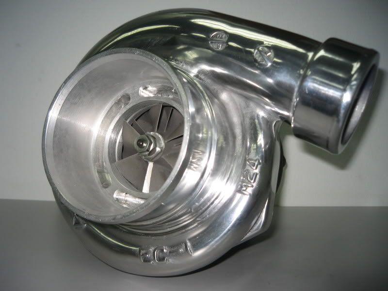

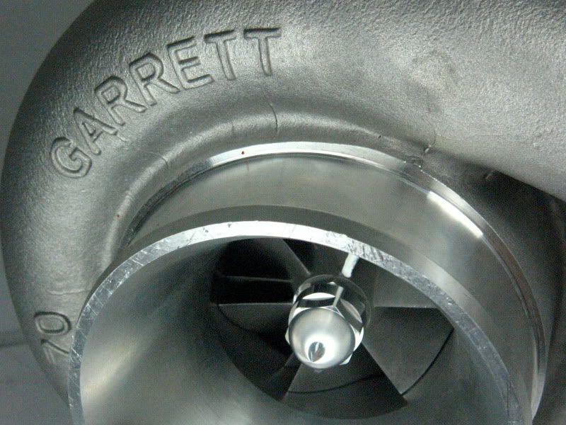

GT35R with optional ported shroud housing

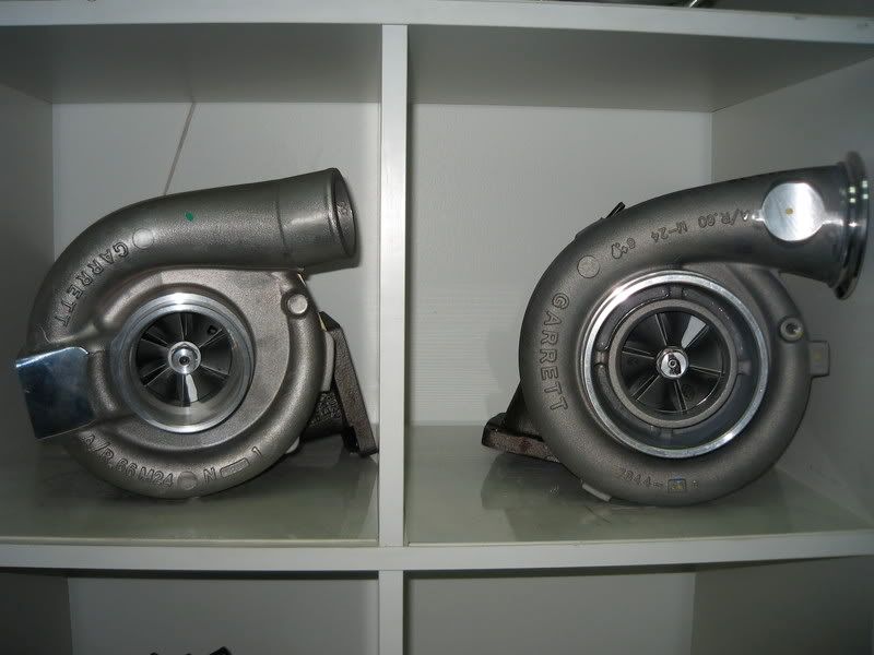

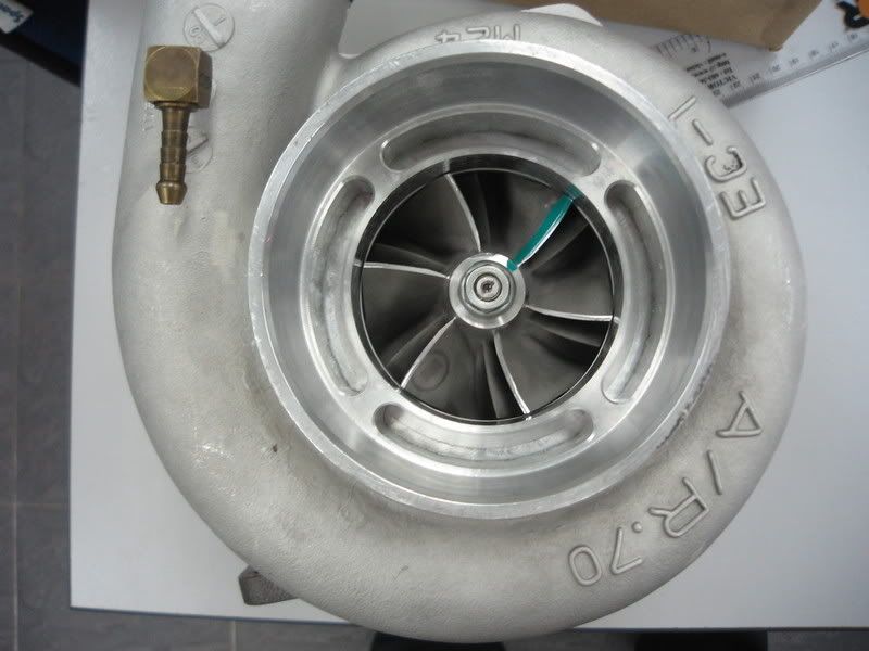

GT4594R vs GT4202R

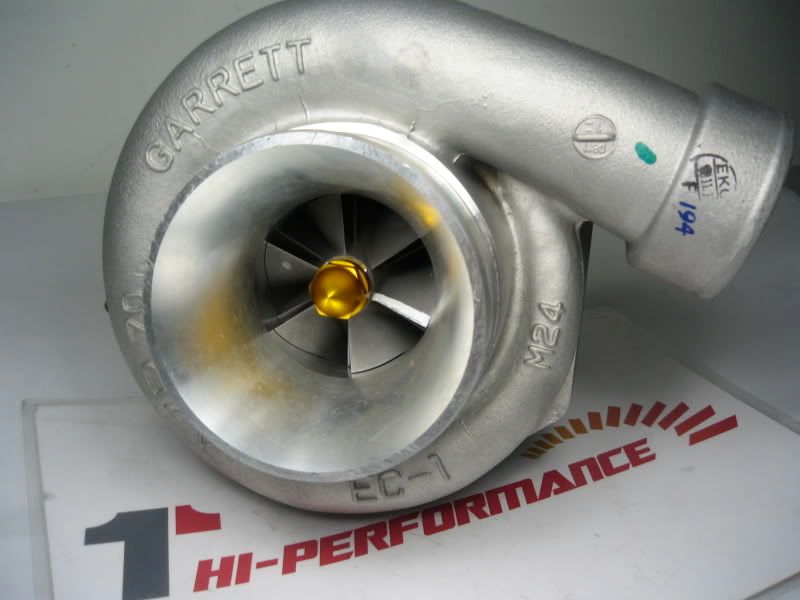

GT4094R

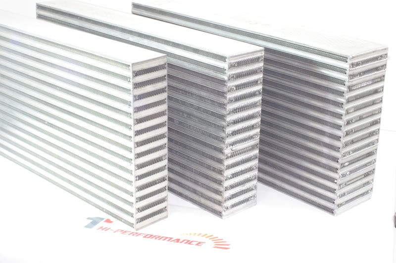

GARRETT Intercoolers... *core only*
enjoy fellow Mitsu mates... :driver:

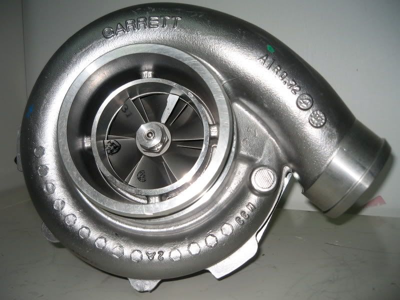

GT4202R vs GT4094R

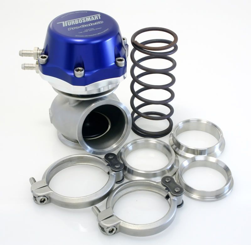

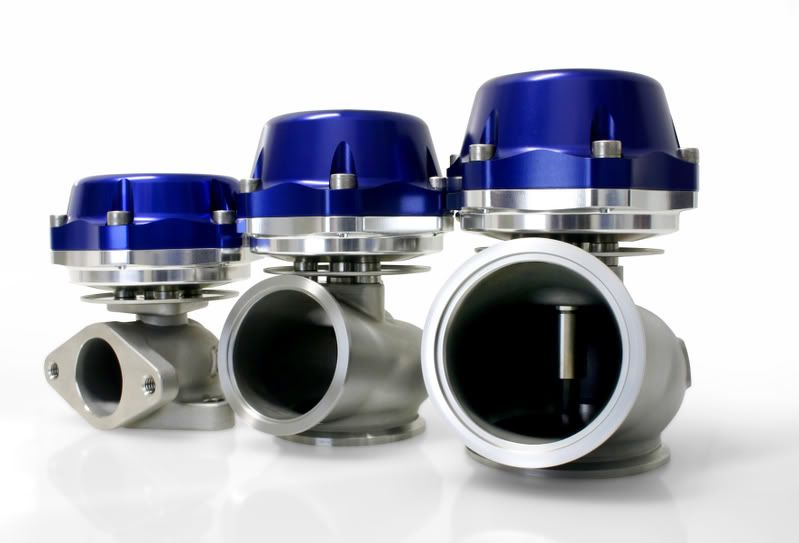

Turbosmart Wastegates (38mm / 50mm / 60mm)
Pro-Gate 50mm :love:

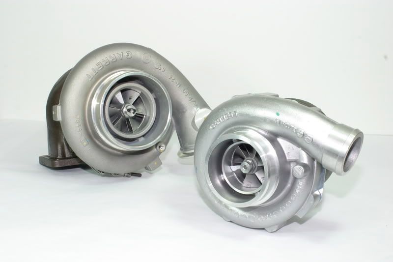

GT4202R vs GT4094R

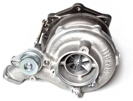

for EVO's we also have the EVO X direct bolt on as well.....

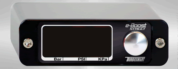

and the latest e-boost STREET which is a real yummy thingy...
