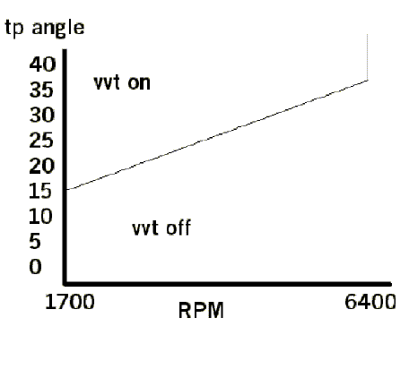

2) is it VVT start after around 3k rpm? coz before 3k, power like normal car, after tat can hear the sound of VVT kick in.

Actually VVT activation is not like VTEC. VTEC will engage at certain RPM but VVT will engage by referring to this graph. VVT will start engage as low as 1700 RPM when throttle angle is more than 15.
