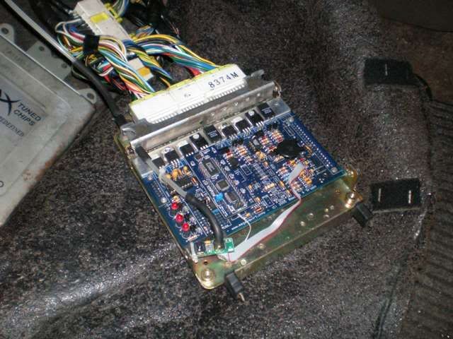

latest update,
MS-2 in OEM ecu casing for disguised. Currently being fitted in 4G63T EVO 2.
will update other pics once i got the time.
So MS-2 is compatible with the 4G63T? Which one will be an ideal option MS-1 PCB3.0 or MS-2 PCB3.0? Thanks in advance.
