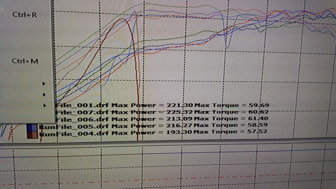

Also, the dyno chart somehow i think is showing an incorrect torque numbers?
That is in Kg, not nm......:smokin:

That is in Kg, not nm.....:smokin:
but 60kgs torque from TD05, i think is not so accurate? could it because of the auto transmission torque converter which is not able to read the proper torque?
Oh yah! 60kg is like 594 nm......:rolleyes:
Wow 594Nm of torque? That is a lot. Feels more like 2.4L stroker kit power! Mine only 380Nm on wheel.
Well, torque can be a lot more than Bhp and it exists on engines from bus and trucks, hehehehe.. just joking.
Yeah, for a 4G63T, that really doesn't match well.

by the way, is the dyno chart a real dyno one or just the simulation program?
is live dyno tuned, i was there with the tuner

I see... well, I don't think the torque is correct based on your hp. Maybe the dynometer needs callabration... I don't know, just guessing.
in what gear they run the dyno? lock OD off or use manual shifter option? (not sure how trek auto trans setup the gearing combination)
if they did run on wrong gear surely torque was massive...but didnt match really....or it just simply because camshaft differences between evo and trek
Is on manual shift on 2nd gear all the times, the final gear ratio for this car is too tall, 3rd gear easily hit 180kph.
