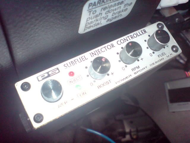

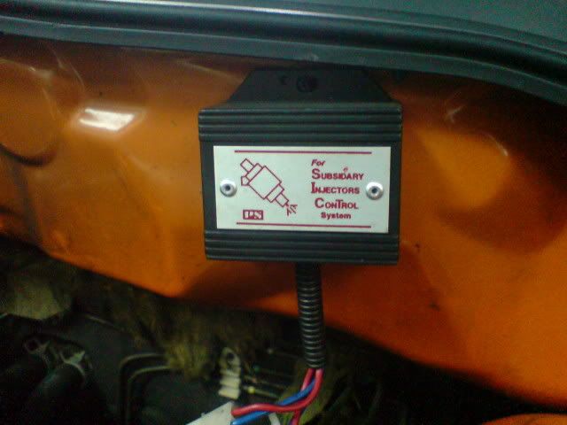

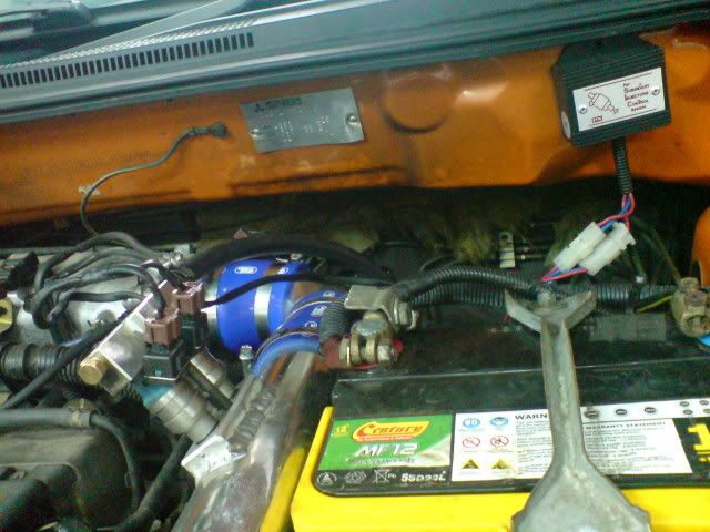

(3.1) what do you mean by 'subsidiary fuel injectors'?
Here is some pic of the PS SIC :)
once again, the users came to the rescue of the product. its really sad to see the non-existent commitment of PS reps over their own product.
to the users, tks for clarifying the stuff that i asked and also the pics. like jin has said, AFE works but can it really outperform a standalone? from my viewpoint, it is a definite NO.
