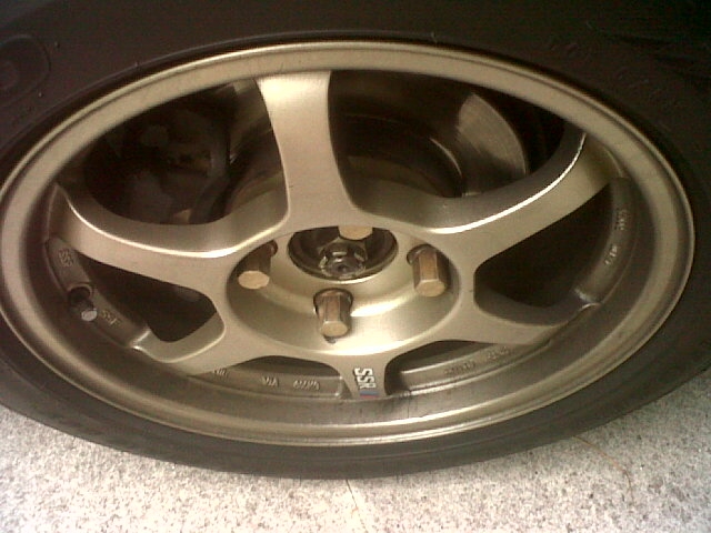

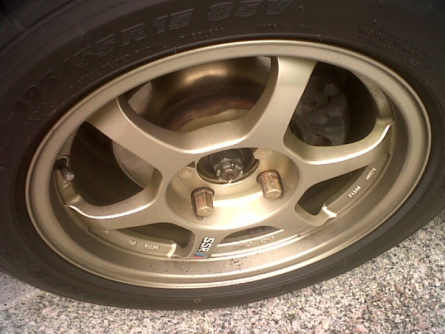

Hello forumers,
i want to ask few questions with regards to brake system....
Q1. why is it that my right hand side brake produce less dust than my left hand side? (front brakes)
Q2. if so, how do i resolve this issue?
FYI im using gsr brakes (caliper + disc) which bought from chop shop. running with ebc pads, steel braided hoses, original waja knuckle to retain my abs, original waja brake pump n other brake parts original waja. Before install i have also serviced the brakes n dispose the old pads. So far its working great, just the sight of the dust makes me wonder......:confused: (check images attached)

For your brakes, check by touching the rims after a run, whether your left rims are hotter then your right rims. If they are, either your floating pin is dirty therefore caliper cannot return fully, or the brake piston are dirty and not returning fully so your pads are still in contact with the disc rotor.
Servicing the pin or the piston (find the fault first) will solved this problem.

ok, will do the checking later..... how often do we need to service the brakes?
well, as for evo3 brakes, even std evo3 is using 15 inch rims... but when installed to a 15 inch theres enough gap that i can see between caliper and rim (around 1inch plus).... thats why im looking for sumtin to fill up the spaces.... like those gtr n all.....hahaha can custom fabricate ka?
Well, normally can last pretty long, like a few years, or until you have problems like now. If you let it go on, the left brake pads will wear out faster. But it is recommended to change brake fluid once every 1 to 2 years.

Then probably the left side biting more or getting jam and for the vibration I suspect your disc rotor warp already. Check and if if still thick, then go for skimming. If thin already then need to change....might as well upgrade.....
how to check bro? anything i can do to adjust the brake balance? is the answer service the brakes? when u say upgrade it means upgrade the disc or the brake system? your current twinport or evo3 twinport, is it a good upgrade bro?
if both caliper and disc came from same model (left right) i don't think the brake balance between left and right would be a problem is the caliper and disc in good condition...
first..try service your brake....during service a person could detect the problem (brake jam one side/caliper pin stuck or anything that cause it)
also can properly check disc surface condition during that....
regarding your steering vibrate and constantly pulling left i think its due to improper wheel balancing and alignment....
to add your suspicious to the brake caliper...then lets say after any trip (short or long) first thing to check after u stop is your brake..by touch the rim area with your palm....if one side brake jam u'll feel that the jammed side would be hotter than the other side.... :adore:

For uneven braking and in case one side is jamming up, look at brake dust on the front wheel. If one side has more brake dust then the other after one week use, is sign of brake pads binding. Another will be after a run like from office back home, immediately touch the rims. If one side is hotter then the other another sign of pads binding. Pads binding can be either the floating pin dirty or the piston jamming up by dirt/rust. Then only thing to be done is to clean service these two areas.....
Steering vibration can be either from warp disc rotor or even the uneven braking. Have to check.
If from uneven braking then after cleaning/service the brakes then should be okay. If not, then rotor needs to be skimmed. But for skimming rotor need to be thick. Check for minimum thickness. If too thin then need to change. This is where I ask you to upgrade, meaning since need to change might as well upgrade.....
