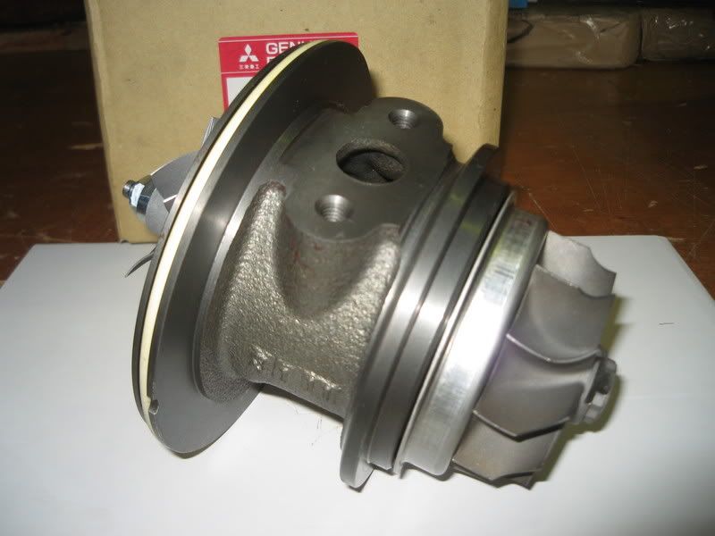

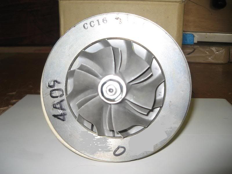

i have a couple of 20G coming in... ETA in 2 weeks time...it will be a full TD06-20G spec using a new designed turbine trim (11blades vs current 13 blades)
Price...? heh heh....ring for best price...

Best turbo for the 4G93T for a daily driven car with a tad bit of power..hehe...is as follows :
High Budget : Garrett GT28 series and the Garrett GT30 series
Low to Medium Budget : VR4RS,Evo I and Evo II turbine, and the most reccomended/value for money is the slightly larger Evo III TD05 16G
feel free to add/update the list guys..
